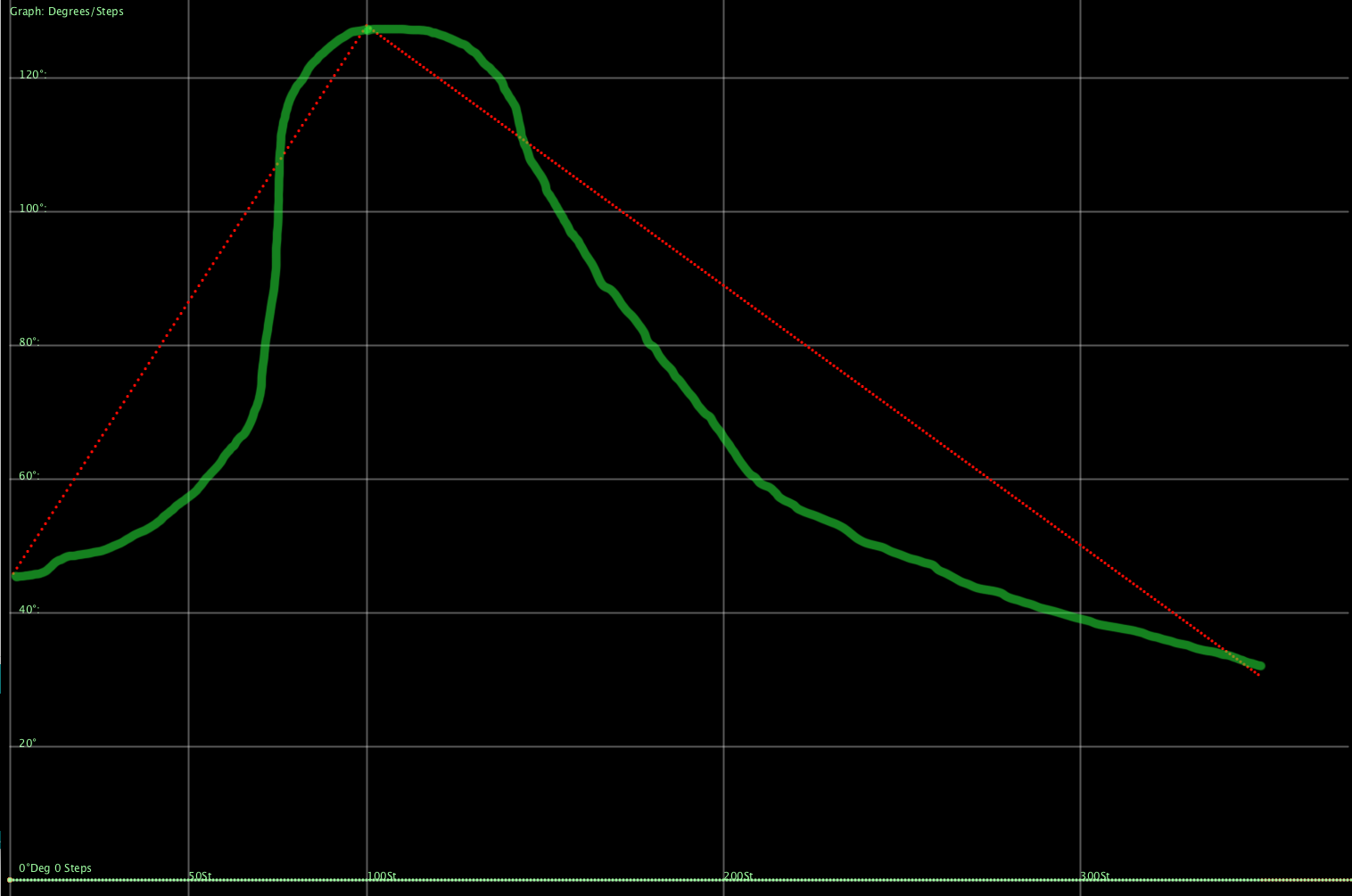

How to smoothen an array of values based on 2 waypoints?
My math is weak, hope to get some help from someone .
I am building a robot and I am looking for smooth motion.
I developed an micro steps generating function based on:
Encoder reading- the origin of motion,
First Waypoint to go (degrees)
Microsteps to the first Waypoint - int
Second Waypoint
Microsteps to the Second waypoint.
I am getting a good micro steps but the motion is rude and jerky because is linear.
All smoothing libraries are referring to an analog input so I can't feed my micro steps array...
See attached pic, the red is the micro steps generated, the green would be the motion I would like, (Drawn by hand)
Thanks a lot, I know this is not easy....

What's the criteria for the smoothing?
"Dollars to donuts", I bet this request is for an accel/decel curve. A sin2 function would be great for that... but the code is too opaque to speak to.
you know three sets of points (x,y) being on the curve (where you are plus your two way points) then If you take a second degree equation (quadratic equation) like this
y = ax2 + bx + c
Then you can (generally) find a,b and c. It’s a simple 3 equations / 3 unknown thingy and you’ll find documentation on the solution all over the web.
Then once you have the coefficients it’s just a matter of changing x in small steps (sort the X increasingly or decreasingly) and calculate the associated y and move there. The smaller the deltaX the smoother the interpolation

I think I figured it, looks nice
Thanks JML , Did you mean this also?
