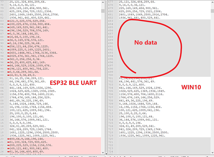

HI! I tried to transmit at the rate of 36000 bytes(Send the notify of the device continuously), but win10 bluetooth receiver has packet loss phenomenon, although there is no lack of comma or period, Win10 received Bluetooth packet string is relatively complete, but missing more than a dozen complete packets, as shown below:
BLE: ESP32 DEVKIT V1
PC: NOTEBOOK COMPUTER
Win10 Code:

BLE typically has a connection interval of about 30 to 50 milliseconds, so it can only send 20 to 30 packets per second. HID devices can have the fastest interval of 15 milliseconds (depending on the configuration) which would be 66 packets per second. The maximum MTU is for most devices is 512 bytes, so this would give 66 * 512 = approx 34000 bytes per second. So perhaps the buffer on the ESP32 is overflowing from trying to send data faster than what is possible.
I tried to reduce the speed to 8000-10000 bytes, but it still lost packets.
I have no experience in bluetooth debugging. I need to ensure a high rate of data transmission and avoid packet loss.What is the solution for ESP32 sending buffer overflow?
Thank you for reading this question.:grinning:
I tried to use classic Bluetooth, but got frustrated along the develop. I had the same problem from the url: https://forum.arduino.cc/t/bluetooth-not-working-with-windows-10-and-not-working-with-android/920136
To solve this problem, use the Python third-party library Bleak to detect the upper limit of the MTU value of Bluetooth to maximize throughput and thus reduce packet loss rates.
