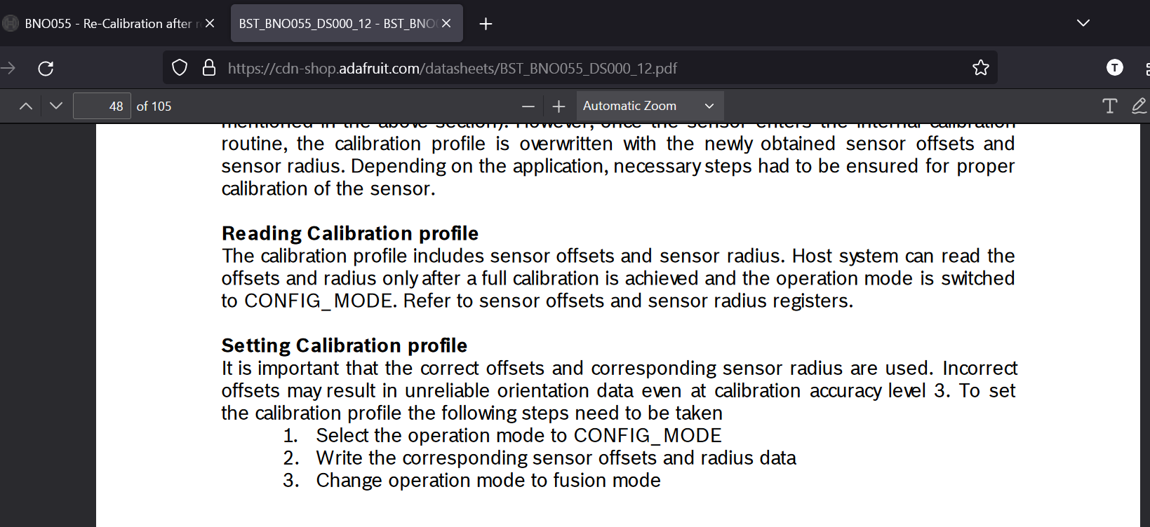

Thank you for your replying. I feel relief that sound not more step to finish. I am now a bit lost, because it can not seen where I can get the Reading Calibration Profile.
From the datasheet of BNO055
on first step. >[]<)/
in the link you provided, @ispybadguys seems to provide functions to read the calibration data.

so you have the code to read the configuration and write them
what's your issue? writing to EEPROM?
I am not so sure how it must be, I guessed I can use above code in ARDUINO IDE. When I tried, it showed error. That made me wonder where else the code need to be utilized. either another c file of BNO055 or somewhere new.
