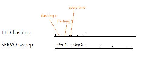

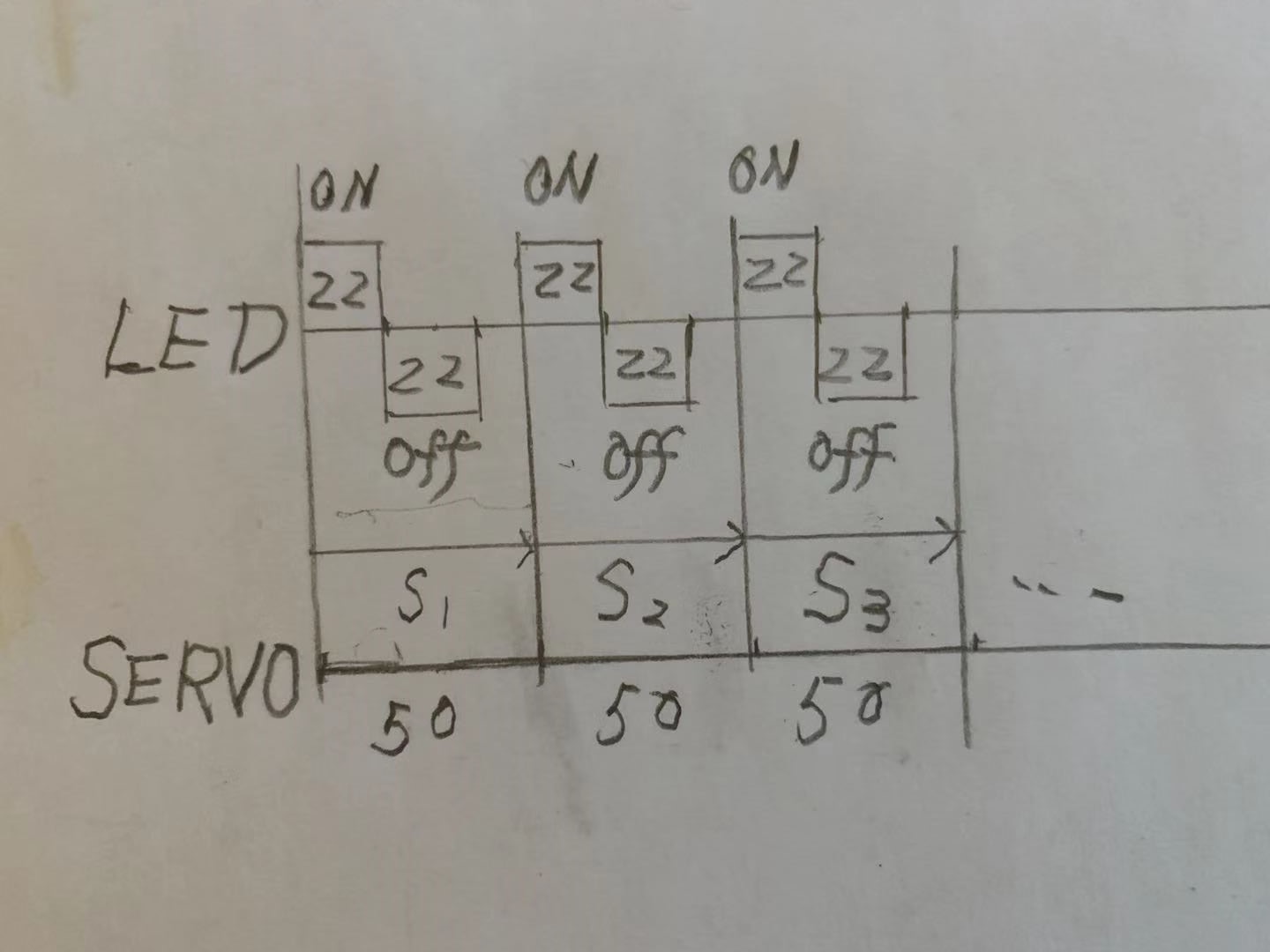

I have a SERVO rotate 2 degree every curtain time (50), I like the LED on/off 2 times at (22), can the below code do it?
can the LED flashing exactly 2 time at each step? or it just keep flashing itself? possibly synchronize each step with a flashing phase?
if I'd like the LED just on exactly 4000 - less than SERVO sweep 90 steps' total time? can just change:
const unsigned long Ledperiod = 4000;is OK?
and possibly synchronize each 90 steps with one flashing phase (4000)?
how about the LED do in the other 500 when the SERVO sweep?
in testing 1, I can see barely the LED flashing when testing.
Thanks
Adam
