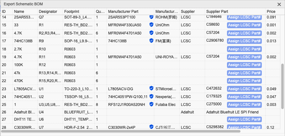

Hi, I finally finish the Pyro Diagram. I used a MUX to use fewer pins. I have a few questions, just to make sure I am Drawing Correctly.
In the Pyro Diagram, there is a 470k resister Like R15 and a 100K resister like R12.
The 470k, Is this a typo Should a 47K resister do the Job to protect my Teensy pin?
For r12 is 100k ok, or too Much?
I have included the BOM file Image for reference
Thanks
