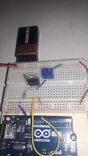

I would consider myself a little big more then beginner. I am slightly confused by some of the things you said so i thought i would just post the actual wiring image.
The transistor used is a IRF520. The code will switch the pyro on and off in a loop. The blue screw terminal is where i put the probes on the multimeter onto and get 9v on, the off (the code looping)
Sorry if i misunderstood anything.
When you want to control a MOSFET with an Arduino, you need a logic level MOSFET.
Your IRF540 is not the correct type of MOSFET for this application.
You need an IRL540 or one of the MOSFETs listed, bottom left, of the schematic offered above.

so i learn, what is wrong with using the one i currently have?
An IRF540 requires 10V on the gate for it to turn on fully.
Your 5V UNO will not fully turn on an IRF540 MOSFET.

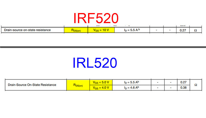

Not trying to be a know all, just trying to get understanding. Why would the arduino kit include a mosfet that it cant use? From my quick reasearch, the IRF520 needs 4v ( IRF520 MOSFET Pinout, Datasheet, Features & Alternatives (components101.com)) .

  • Gate threshold voltage (VGS-th) is 4V (max)
    The line above is the voltage where the MOSFET is essentially turned OFF.
You want to look at the datasheet line as seen below.

You keep mentioning the IRF540 but the mosfet says IRF520. Just checking you are not thinking the wrong one? Everything seems to work absolutely fine with it
Same difference.
An IRF520 is 10V MOSFET
An IRL520 is a logic level MOSFET i.e. for the 5V UNO
