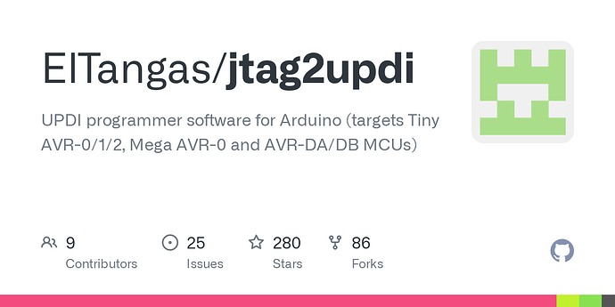

[You need] a UPDI programmer.
There is an equivalent of "Arduino as ISP" that supports UPDI:
