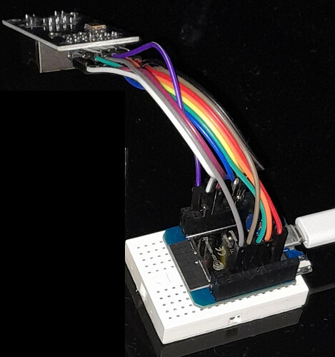

And my connections :
|GPIO21   |  TX_EN|EMAC_TX_EN|
|GPIO19   |  TX0|EMAC_TXD0|
|GPIO22   |  TX1|EMAC_TXD1|
|GPIO25   |  RX0|EMAC_RXD0|
|GPIO26   |  RX1|EMAC_RXD1|
|GPIO27   |  CRS_DV|EMAC_RX_DRV|
|GPIO17   |  EMAC_CLK_180|REFCLK|
|GPIO23   |  MDC|Output to PHY|
|GPIO18   |  MDIO|Bidirectional|
Thanks in advance

but I didn't use the Dev Kit because it is wide for the breadboard. I used an ESP32 D1 mini
I'm going to try it with an ESP32 D1 mini, I found one in my drawers.
I redid the wiring with the ESP32 Di mini, with the patch and without the patch.
I still can't get a network connection.
Could you give me a hand because I'm completely lost now.
the patch is necessary, if the esp32 doesn't start the sketch with LAN8720 wired to io 0..
did you change in sketch the ETH_PHY_ADDR to -1?

so it looks like ADDR 1 is OK.
is the LAN module properly connected with a cable to a switch or router?
EDIT: Is there a DHCP server on the network you are connecting to?
The LAN8720 module is connected to a hub which is connected to the router.
I don't know if I have a DHCP server on my network.
After multiple attempts, I have the result below, but unable to retrieve the Mac address and local IP.
Do you have an idea?

try it with static IP.
  IPAddress ip(192, 168, 1, 177);
  IPAddress gw(192, 168, 1, 1);
  IPAddress dns(8, 8, 8, 8);
  IPAddress mask(255, 255, 255, 0);
ETH.begin();
ETH.config(ip, gw, subnet, mask);
use valid addresses for you network
Thanks @Juraj
We are making progress but it is still not operational.
However, I modified:
By :
ETH.config(ip, gw, dns, mask);
The code for my network:
  WiFi.onEvent(WiFiEvent);
  IPAddress ip(192, 168, 0, 42);
  IPAddress gw(192, 168, 0, 1);
  IPAddress dns(89, 2, 0, 1);
  ETH.begin();
And here is the return of the serial monitor:

On my box I can clearly see my esp32 with my Ethernet module:
But I don't receive any ping:
C:\Users\treza>ping 192.168.0.42
Envoi d’une requête 'Ping'  192.168.0.42 avec 32 octets de données :
Délai d’attente de la demande dépassé.
Statistiques Ping pour 192.168.0.42:
    Paquets : envoyés = 4, reçus = 0, perdus = 4 (perte 100%),
check the wiring of the RMII pins especially RX pins
I just checked.
The wiring is good, I have continuity between the ESP pins and the LAN8720 pins
but are they on the correct pin?
I rechecked the pin connections and even several times
