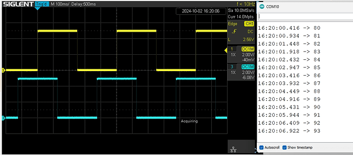

I don't have the same hardware as user123-name_valid, but I managed to test your code satisfactorily.
I used an Arduino Uno R3, so I changed the pins to 2 and 3.
I fed two 2Hz square waves from a function generator into the two inputs.
With the phase of the second square wave at 90°, the code counted upwards.
With the phase changed to 270°, the code counted downwards.
