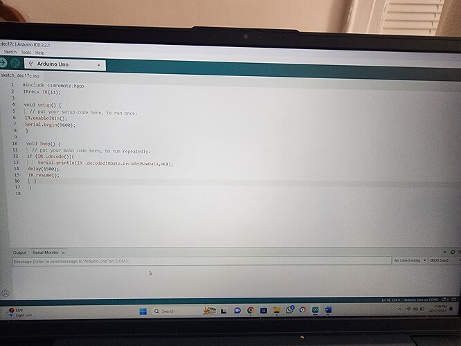

and when i upload it its said uplod is done but when i press button on my ir remote nothing is showing on serial monitor and my serial monitor also look different .pleas guide me what I'm doing wrong

  • Copy your code/sketch and paste it here for us to look at it.
    No pictures please.
#include <IRremote.hpp>
IRrecv IR(11);
IR.enableIRIn();
if (IR .decode()){
Serial.println(IR .decodedIRData.decodedRawData,HEX);
delay(1500);
IR.resume();
  • First off, you do not need this line of code delay(1500);.
  • Your code works fine here.
  • If your wires are all good, you must have damaged your receiver when you wired it wrong.
