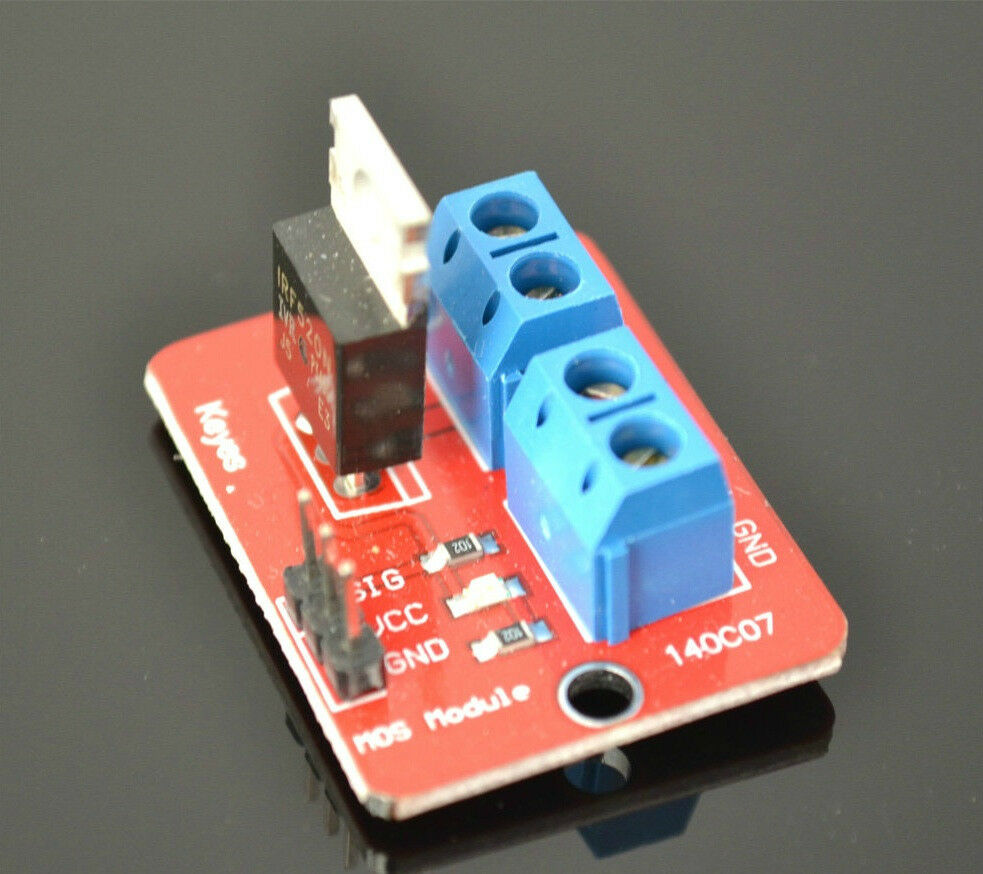

Actually, whilst you should use a logic-level FET (and forget the transistors) for the half Amp at which this is rated, you can use one of these:
When I look online for a part to buy what specifications do I look for?
Such as what voltage and amperage are necessary for this magnetic lock?
On the schematic in post #6, left of the title block are suggested part numbers that would work.
