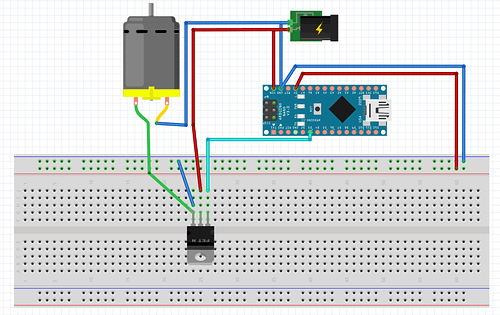

Will this work because i'm not sure whether the schematics will work or not
People keep asking you what motor you have, what you want to do with it and what battery/power supply you will be using. You never answer so how are we going to know what will work for you?
That isn't a schematic. That picture is useless. None of the components are marked. It has no resistor on the MOSFET input and apparently no diode and I have no idea what the thing with the spark is supposed to be...so no it isn't a good example.

Can you please post a picture of a hand drawn circuit in jpg, png?
Include part numbers and your power supply please.
