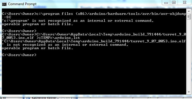

I put this in "c:\program files (x86)/arduino/hardware/tools/avr/bin/avr-objdump -d C:\Users\Owner\AppData\Local\Temp\arduino_build_791444/turret_9_07_0053.ino.elf" and saw what looked like a hex dump. Hard to tell since it was there and gone in a few tenths of a second. Appearance is like a DOS window, white characters on black .
Yes; it's a command-line-style utility, so you'd normally run it in "Command Prompt" window, and pipe it through more or redirect to some output file. Also, you probably want to use "-SC" instead of "-d", as that should give you a mixed source/assembly listing with C++ symbols de-mangled, making it easier to follow.
c:\program files (x86)/arduino/hardware/tools/avr/bin/avr-objdump -SC C:\Users\Owner\AppData\Local\Temp\arduino_build_791444/turret_9_07_0053.ino.elf >%TEMP%\arduino.lst

Here are my results from entry in a command prompt window. Perhaps I've lost too many brain cells.
