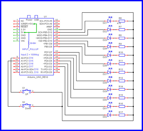

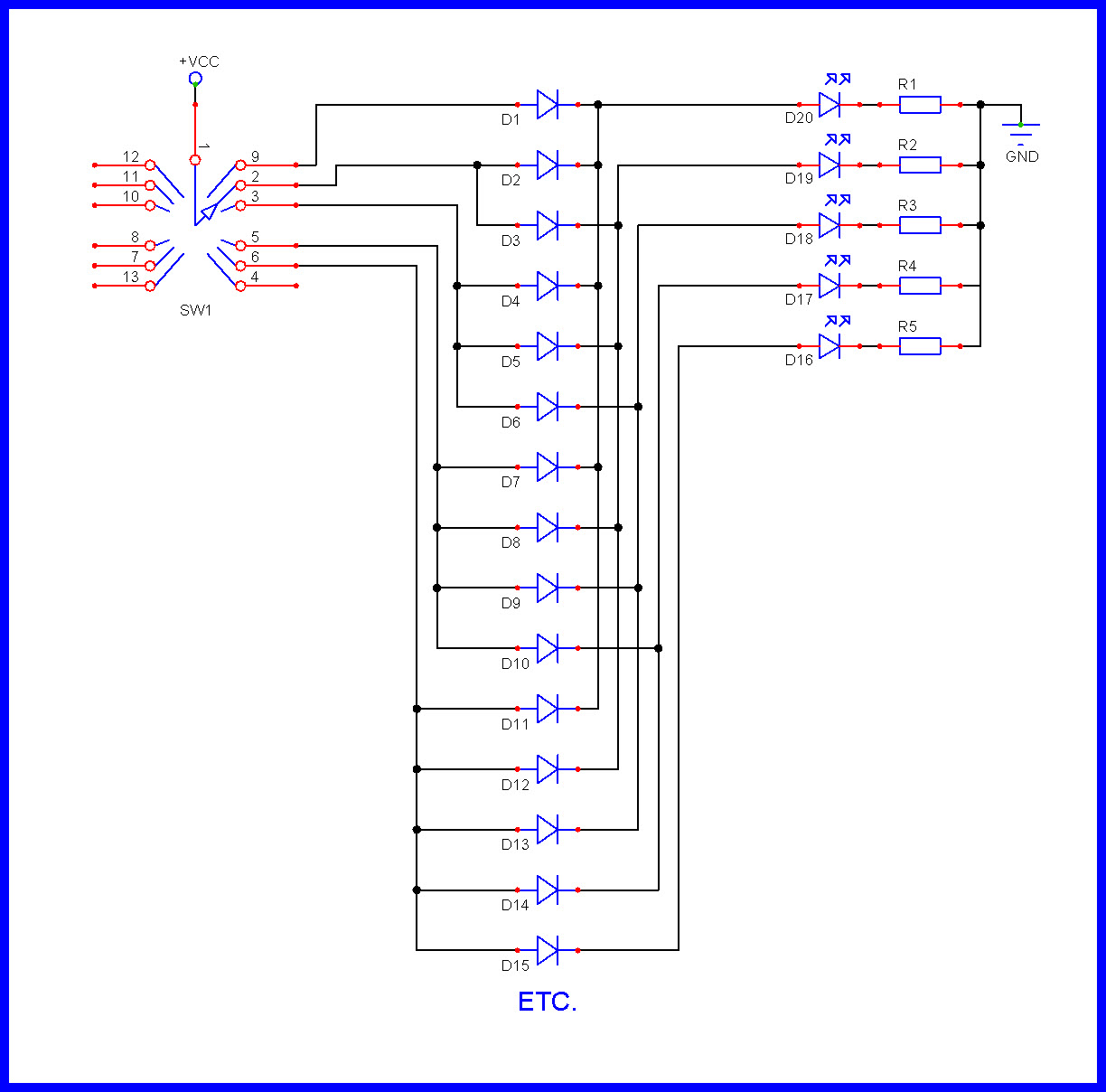

Has anyone wired this 12 pos switch so that some leds can ( as in a 9 LED Minorah candle ) can be lit...one at a time, additionally. Such that some action ( rotary, or other) selects one led, then one and two, then one and 2 and 3, etc.?
I'm a led lighting artist, but not an electronics genius.
Ray Locke, Venice, fl

You can do this with a 12 position rotary switch and diodes.
However, you can use two switches, count up & count down, along with 12 outputs pins on an Arduino.
