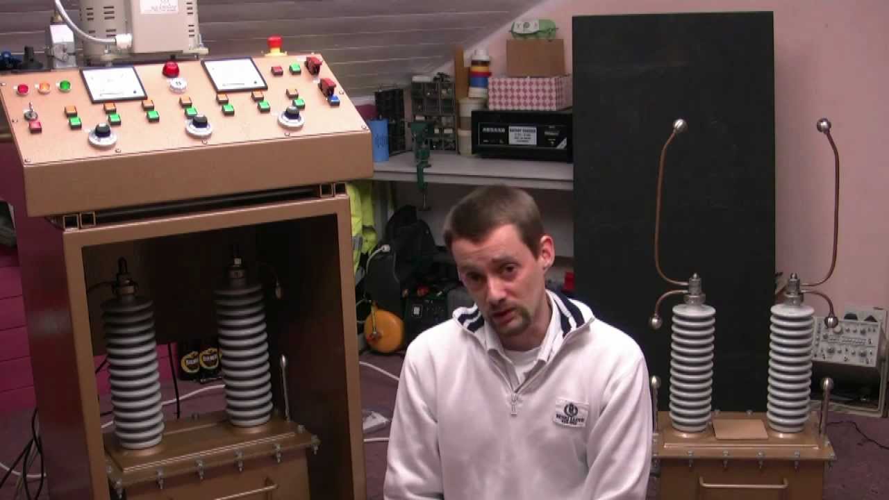

Here is a "big boy's power supply" 200-300kV.
I think the bloke is insane, he seems to know what he is doing but I would not be surprised if his vlog stopped abruptly one day.
