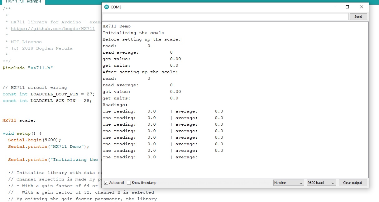

AND NOW... If I use the exact code with the Sparkfun serial segment display, change the pins to work and select the board and com port:
// HX711 circuit wiring
const int LOADCELL_DOUT_PIN = 27;
const int LOADCELL_SCK_PIN = 28;
This happens:
All Zeros!
I've seen this problem with the hx711 and Arduino Uno (Atmega328) before:
Could there be an issue with the code and atmega328?
