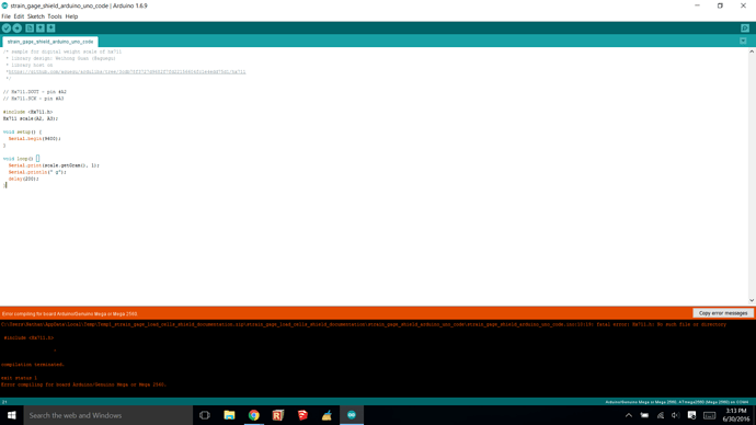

Hx711.h: No such file or directory error help
Hi so im pretty new to the arduino world so im sorry in advance if my lack of common knowledge gets draggy here but im trying to upload a code to my arduino for a load cell project and ive run several didnt codes and it keeps giving me the same error saying - Hx711.h: No such file or directory. am i missing something here? any advice is highly appreciated!!
Capitalization (or not) is important. Be sure your "include" matches the library name. Looks like you should be using
#include <hx711.h>
not
#include <Hx711.h>
