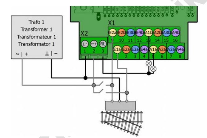

The connections are shown in the next picture:
WRM-4
I don't wont to connect a led on A1a , A1b, A2a, A2b, A3a, ... and so on, but I want to get the signal into my Arduino to control and track the trains.

Are you measuring DC voltage (using a voltmeter), or AC voltage? I ask because both the transformer and the WRM-4 module show a designation of ~|+.
Not sure if this is a DCC system or the old-style AC transformer, but the "~" symbol makes me think this is an AC voltage, and the +|- symbols are just there so you can have a common "ground" side that goes round your track, while the "+" side is transferred to the "hot" rail via the switches.
The 817 modules will only respond to DC signals, so if you're interfacing to this using AC, this isn't going to work.
Can you connect an LED between both rails on a known-hot section of track (maybe with a 10K resistor on one LED leg) and get it to light up? If not, you're dealing with AC.
