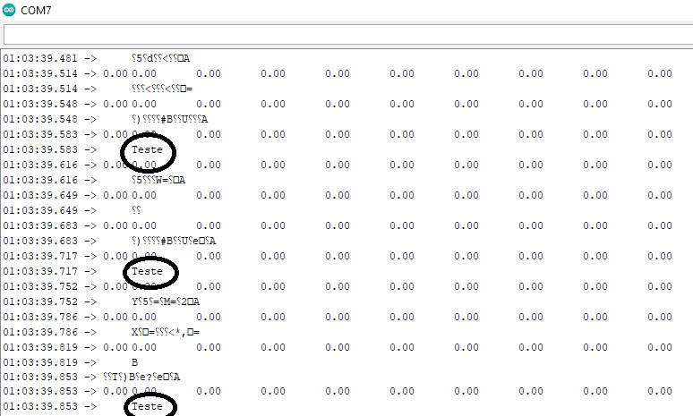

I am able to send text through nRF24L01 but can't send an struct
I have an Arduino Pro Micro + mpu-9250 + nRF24L01 mounted on a pcb and and I'm transmitting data to an arduino uno + nRF24L01 connected to the computer. With the following code I'm able to print the text on the computer screen, but not able to print the mpu data. I get this in the serial monitor:

You are using it bad..
At Transmitter and also at Receiver side.
Try my verified examples and edit them for your usage :slight_smile:
Transmitter code example with struct:

augustinto:
With the following code ...
Please include short programs in your Post using the code button </> so we don't have to download them,
Sending a struct should be straightforward - just like sending an array.
MyStruct myData;
radio.write(&myData, sizeof(myData));
and you should receive the data into an equivalent struct.
...R
Simple nRF24L01+ Tutorial
Thanks Robin2 and martinius96, I'm new here. Sorry for not using the code button.
Gonna try again with your tips and I'll get back to you with the results.
