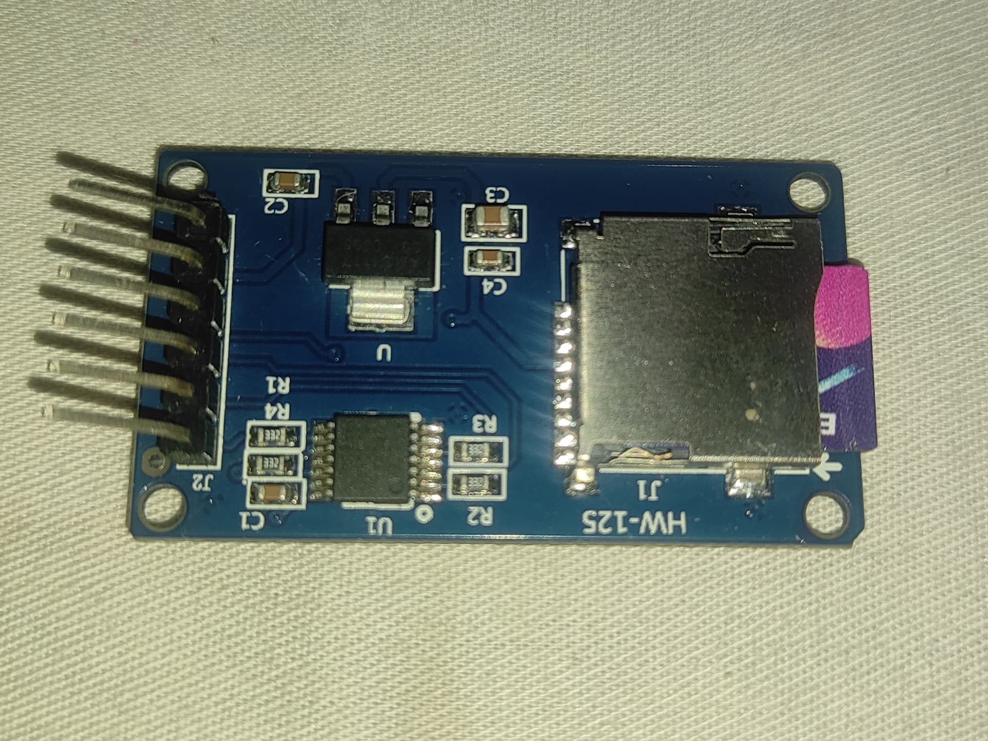

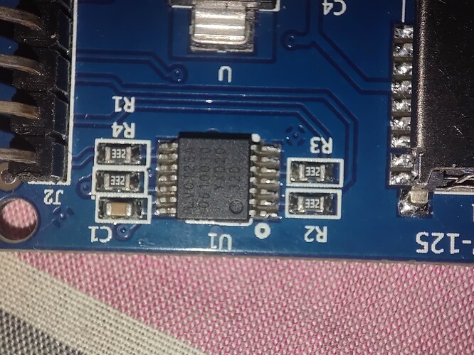

I am having problem in using two SPI modules at the same time with Arduino UNO. I am using Arduino UNO for capturing picture with OV2640 Arducam Mini 2MP and SD card module. I have connected SD card module and camera module at the same SPI pins as Arduino UNO has the same SPI pins( MOSI, MISO, SCK). The CS pins are different for two modules. But if two modules are connected in circuit it shows SPI interface error. If anyone can give me a solution it will be really helpful.
I am using the following sketch.
