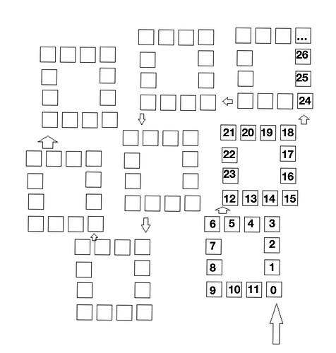

I have a conditional strip of 93 LEDs. There are several "masks" for turning on individual pieces of the strip in different modes. For example: 000000000000000000 - the strip is off.
Masks 1100 and 1010.
001100000000001010 - masks are applied in positions 1 and 2 (without changing other sections of the strip)
001010000000001100 - masks are applied in positions 2 and 1 (without changing other sections of the strip)
A question about examples of such code (i use Adafruit NEOPIXEL). I am not a programmer and do not even know how to correctly formulate a search query ... I looked at the projects of some watches and some matrix, but did not find anything similar. Thank you.

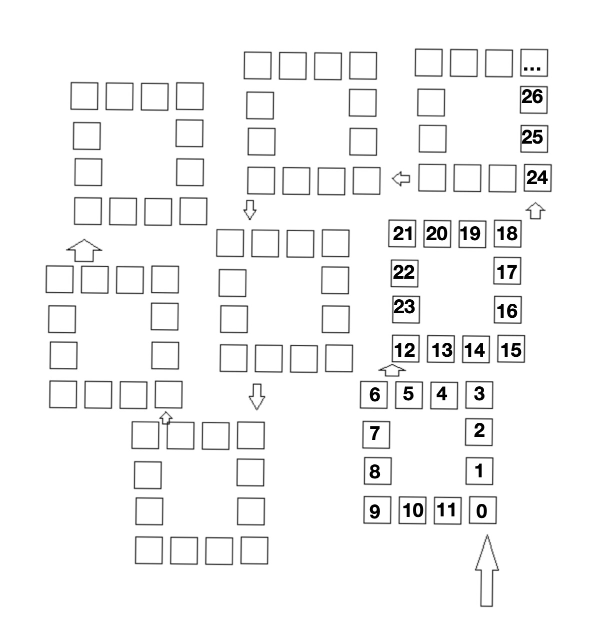

Let me try to explain it this way. Here in the picture there are three states 1 2 and 3. Conventionally, 1 and 0 are simply on and off (color is not important). I could, for example, use a for loop, go through from 13 to 25 and turn on the green one. And there is even such an example in the library and I understand it. However, if I need to turn on 110010110001, then I can’t do it with a simple loop. Or I don’t know how. There is an array with masks, but I don’t understand at all how to use it to turn on the desired section of the tape. All I can do is turn on a specific LED or light them one by one.

Looking at your drawing, you have 8 squares made up with 12 leds (so 96 leds total) and they are arrange in a strip from what I gather from the small top view and the arrows, so the led numbering goes like this
numbering starts at 0 so this would actually be from 12 to 23
