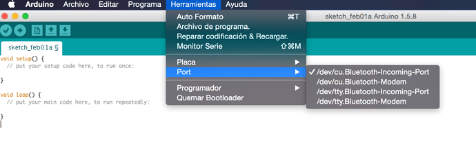

I don't know why... but I think is because in "port" does not appear "usb"...
I just buy it, i run the blink example and never upload it... Always "uploading".

Your Arduino is not being recognized as a USB device. Exactly what model Arduino do you have? Some models need a USB driver.
Leonardo ;D

Run the "Applications/Utilities/System Information" app. Look for the Leonardo under Hardware/USB. Mine says:
Arduino Leonardo:
Product ID: 0x8036
Vendor ID: 0x2341
Version: 1.00
Speed: Up to 12 Mb/sec
Manufacturer: Arduino LLC
Location ID: 0x14100000 / 8
Current Available (mA): 500
Current Required (mA): 500
If it doesn't show up you will probably need to burn a fresh bootloader.
HELP!! In "System Information" does not appear nothing, then i burn the boot loader and appear this:
"avrdude: error: could not find USB device with vid=0x16c0 pid=0x5dc vendor='www.fischl.de' product='USBasp'
Error quemando boot loader"
I think the problem is my mac because today i bringed the board to the store and it was working perfectly! Arrghhhhh...
What can i do?
regards, Guille

To burn a bootloader you need an ISP device. I suspect you have not bought one yet. You can get a USBasp clone via eBay for about $4. You can get a USBtinyISP for about $5. You connect either to your Mac via USB and select which type you have under Tools->Programmer.
