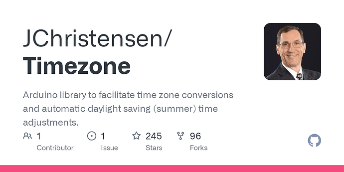

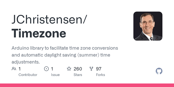

Hi, depending what you are using it for, if you have a clock using the delay, and you live in certain parts of the world, you will be resetting the clock , twice a year anyway.
Tom.... :slight_smile:
Duemilanove has a crystal for the system clock, so is more accurate than an Uno or other board that has a ceramic resonator.
TomGeorge:
That can be avoided
