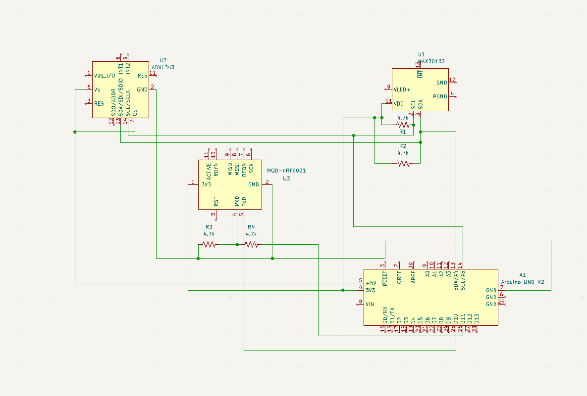

I have a project, i need to detect sleep apnea episodes with oxygen saturation, heart rate and chest movements. I'm using MAX30102 PPG sensor and ADXL345 accelerameter. I connected them like the schematic below:
Right now with the code i can initialize both sensors and bluetooth module. However, appearently I cannot get the correct data from PPG sensor. Below there is my code and output:

This is with the example code from library. Is it possible the sensor is broken or a wiring problem.
Connecting 5 volt UNO output pins to 3.3 volt inputs is bad design, might damage 3.3 volt circuits.
MAX30102 is on 3.3 V
only 5 V goes into ADXL345
Does your max30102 module require 5V or 3.3V. Some only work with 5V even though they say 3.3V to 5V
Are you moving? I believe that the spec for the MAX30102 states that it only provides a usable SpO2 measurement if the person attached is not moving. I don't recall if it outputs zero in that case, or gives an error.
Every soruce i find says 3.3 V for this model. Also i can see the red light is on and i get different red and IR values when i put my finger on it.
Im not moving at all just sitting on my desk checking results.
You miss the point. It's all about the logic voltage level of signals. The I2C signals, SCL resp. SDA from the UNO goes to the 3.3 volt devices!
how can I fix this if this causes the problem.
Does this would work. This was the old schematic.
No that is worse.
Do you have a datasheet for the MAX30102 board you are using or a link to the product webpage?
See the MAX30102 datasheet, (here)

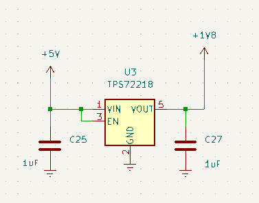

The two key tables for this particular question are pasted below. Notice that the Absolute Maximum for VDD is 2.2V
(If you have a different datasheet for the part you are working with, please post it.)
Solution: Get a 1.8V LD0 regulator for VDD. You might also need a new MAX30102.
There is a circuit below for a 1.8V supply that can run from your 3.3V supply (anything from about 3V up to 7V).
