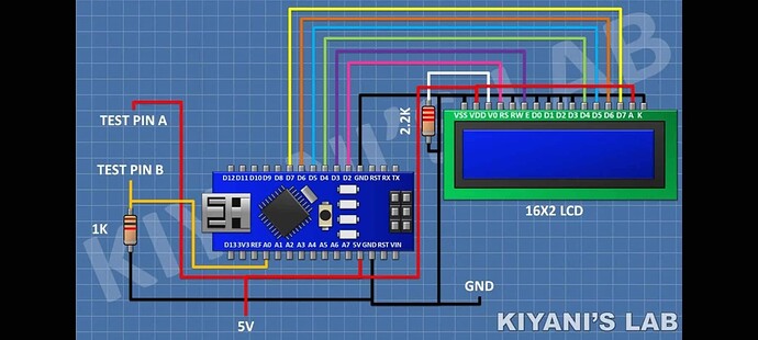

Hi I am new to arduino and I have this school project where i want to use a keypad with arduino but I ran into a problem I can't solve myself. I am using a 4x4 keypad and the issue is that every row works like 1 big button doesn't matter which one I press, only rows register, so basically I can use 4 different buttons but I want all 16. Can someone help me with this? Sorry if I am missing something it's my first time posting here, anyways here is the part of my code that should be of interest (the variables are named in my language sorry for that):

and post also the drawing of your circuit and a picture of you arduino and keypad and how they are connected
I posted it altough it is entirely in my language I don't know if you can make something of it.
This but Test Pin B is on A4 instead of A0 because of keypad.
Remove those 1K pull-down resistors. I don't think the keypad library will work with those connected.

You should not be using the keypad pins except through the keypad library. What are you looking for here?

Oh yeah thank you for noticing, I forgot about that, I'll go and change it right now. (I was not aware that getkey function doesn't stop the loop so I wanted an alternate way of stopping the loop anytime, then I learnt about waitforkey and I understand everything now)
And that is why posting the whole code, and a schematic, is so important. Your original post did not include that code line, nor could we 'see' the resistors.
Thank you! That was indeed the problem!
