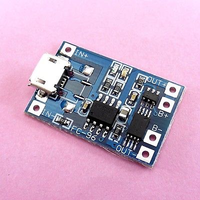

I'm currently building my first weather station which is sending data to ThingSpeak: ESP8266-12 Weather Station - ThingSpeak IoT and also Blynk which I want to power from LiFePo4 battery (still waiting for that from Ebay so meanwhile I'm using fake UltraFire LiPo with measured capacity of 500mAh) and charge it up with solar panel. As a microcontroller I'm using ESP8266 Wemos D1 mini board for testing and in the final version I will be using standalone ESP8266-12 because it will need less current, but it is harder to prototype on. I'm using 5.5V 0.66W 120mA solar panel from ebay http://www.ebay.com/itm/112369092000 and today I did some testing by connecting 10k potentiometer or LEDs or charging board with battery but I was happy if I get 1mA a few cm directly under very strong LED lamp. Then I also used diode but with Vdrop on it it was totally pointless.

5. Can someone recommend me charging/powering circuit for this case? I spend whole week by searching google and I'm just very confused right now because solar panel has max power point which is bad to exceed because I will get nothing from it or what charger should I use? Maybe only LM regulator or some buck converter?

  • You can get modules on eBay for charging Li-ion and LiPo batteries from solar panels. I don't know about LifePo4 batteries, I never looked for them.
