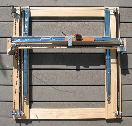

if you look at the cross bar, you can mount a slide on that.
dave-in-nj:
https://www.instructables.com/id/Low-Cost-Hobby-Servo-XY-Table/
That's the sort of thing I had in mind.
...R
To get a 90 degree, you can mount a steel electrical box.
Called a 1900 box, it is a smaller size, about 4 inch square.
The ones that have square sides and sharp corners should work.
You could mount one on each main slide and then mount a board across so the board is vertical.
Then mount your Y slides on the board.
if you look at the main rails, they would mount on the box edges.
put the steel box on each and mount a board across so the face is vertical.
mount two more slides on that. use a threaded rod as the drive.
or belts like shown.
mount the steel cover plate (you can get larger ones) on those and mount your Zee axis on that .
it will allow you to put your box under and then poke down onto each unit to test.
