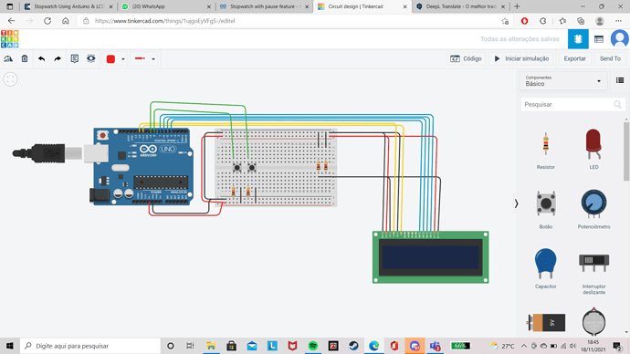

I need to do a timer with 2 buttons(the first to run and pause, and the second to reset), and LCD 16x2
The timer dont work at all, there is the circuit and the code /, someone please test and help me its for today.

There are 1000 millis() in a second.

zero needs to be unsigned long
You shouldn't name a variable the same as a function name. Also, if pausa ever becomes true you will be stuck right here until you reset:
while(pausa);
I'm not sure what you are trying to do with your buttons but since you have those inputs declared as INPUT_PULLUP then you only need the buttons connected to GND and the inputs. Not sure about those resistors.
The first one to pause and run, and the second to reset
This and your wiring don't match. You wired your buttons as active high with external pulldown resistors, but you wrote your code as active low with internal pullup resistors.

There are a multitude of issues with your code. Here are a few:
  1. You shouldn't name a variable the same as a function name. Also, if pausa ever becomes true you will be stuck right here until you reset:
    while(pausa);
  2. zero needs to be an unsigned long
  3. You have sec, min, hora, and zero redefined as locals in the cronometro() function. This causes sec, min, hora to never increment.
  4. There is no reason to call the following every time in cronometro() function. It causes the LCD to blink:
lcd.setCursor(0,0);
lcd.print("Iniciando");
lcd.clear();
lcd.home();
  1. There is no reason to update the LCD unless seconds increases or a button is pushed. It is a waste of time.

I made a Stopwatch with 2 buttons, I want that a button run the timer and pause if I press it again, and the other to reset the chronometer. I did the stopwach run but i can't make it pause, rerun and reset, can you guys help me?

What stops estadoBotao2 being LOW?
'Cause I want that button 1 only reset and the 2 run and pause
I'm sorry, I don't understand your reply to my questions.
