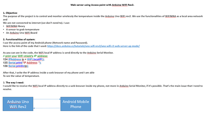

Hi Dave, Hi everyone,
Here are some important point of my project.
Web server using Access point with Arduino WiFi Rev2
  1. Objective:
    The purpose of the project is to control and monitor wirelessly the temperature inside the Arduino Uno WiFi rev2. We use the functionalities of WiFiNINA as a local area network and
    We are not connected to internet (we don’t need to). I use:
    WiFiNINA library
    A sensor to grab temperature
    An Arduino Uno WiFi Board
  2. Functionalities of system:
    I use the access point of my Android phone (Network name and Password).
    Here is the link of the code that I used: https://docs.arduino.cc/tutorials/uno-wifi-rev2/uno-wifi-r2-web-server-ap-mode/
As you can see in the code, the WiFi local IP address is send directly to the Arduino Serial Monitor.
// print your WiFi shield's IP address:
134 IPAddress ip = WiFi.localIP();
135 Serial.print("IP Address: ");
136 Serial.println(ip);
After that, I write the IP address inside a web browser of my phone and I am able
To see the value of temperature.
  1. The way I need:
    I would like to receive the WiFi local IP address directly to a web browser inside my phone, not more in Arduino Serial Monitor, if it’s possible. That's the main issue that I need to resolve.
Architecture:
Thank you.
Aristide

can you clarify if your Arduino WiFi Rev2 actually joins the WiFi network created by your Android phone or if the Arduino WiFi Rev2 actually creates its own WiFi network (it's an access point) and you join that special wifi network from your Android phone.
Hi JML,
inside my code:
I introduce the name and password of my mobile hotsop and Tethering of my phone.
char ssid[] = "AndroidYannicKuda"; // your network SSID (name) between the " BELL972 "
char pass[] = "Password123";
once that, I am able to communicate with the wifi local IP of the Arduino Uno Wifi rev2. The wifi local IP of the Arduino uno Wifi rev2 is send through serial monitor interface pf Arduino IDE.
When I said I am not connected on internet is true because I am using wireless local network to communicate. In this case if I open a browser of another Android phone and tape the previous wifi local IP address it won't work...

Sure, when an Arduino connects to an smartphone via tethering, it gets an IP address from the phone's tethering network, not the WiFi network the phone might be connected to. The Arduino is isolated from that WiFi network and can only communicate with devices within the phone’s tethering network (The phone itself is handling the network routing and may forward traffic from the Arduino to the wireless network it’s connected to to provide internet access). So other phones, even on the same WiFi network (not tethered) can't see the Arduino.
Would you be willing to reverse the roles ? Would it work for you if the Android phone were to connect to the arduino if the arduino was seen as an access point?
It would mean to change your WiFi network on your phone and join the Arduino's network.
