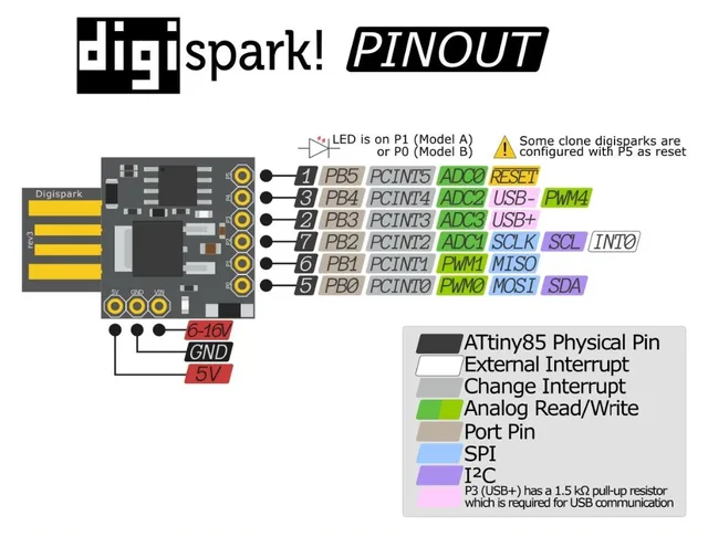

As the title says, I'm trying to set up I2C connection between Arduino UNO as master to Digispark ATTiny85 as slave.
This is the device I have.
Connections:
Arduino UNO ---------> ATTiny85
Pin A5 (SCL) ---------> PB2
Pin A4 (SDA) ---------> PB0
5V and GND ---------> Female usb plug to which the ATTiny is plugged into.
5.1kΩ Pull-Up Resistors on SDA to 5V.
5.1kΩ Pull-Up Resistors on SCL to 5V.
This is what I'm using for the USB connection.

But the led on the Digispark Attiny doesn't blink (I tested that same code on the tiny without the counditionals and it does blink as intended)
  1. Do I require the pullup resistors for this set up?
  2. Am I missing anything else?
  3. Any other suggestions?

Use cable of Fig-1 instead of Fig-2 to connect Digispark Board with PC.

1. The Hardware Setup.
UNO           ATtiny85
SDA (A4)      SDA (PB0)
SCL (A5)      SCL (PB2)
GND           GND
              PB1  -----> onBoard LED
