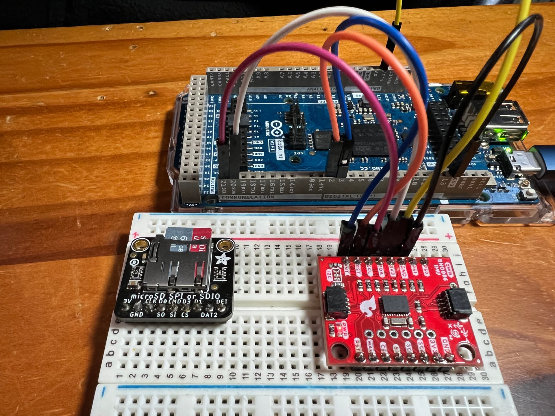

Do you have a Logic Analyzer or oscilloscope to measure the signals ?
Which BNO086 module do you use ? I hope there are pullup resistors on the module.
Can you show a photo with your wiring ?
Using the Sparkfun BNO086: SparkFun VR IMU Breakout - BNO086 (Qwiic) - SEN-22857 - SparkFun Electronics
Yes there are pullups based on the schematic. And 2 the wiring is correct since it does run at 100khz.

It seems a software/timing issue, but I still wan to be sure that your I2C wires are okay.
The Qwiic connector is wrong, and if also the wires are wrong, then the official I2C standard gives you 10 cm for the total length of the I2C bus.
Page 54, paragraph 7.5 of the official I2C standard: https://www.nxp.com/docs/en/user-guide/UM10204.pdf

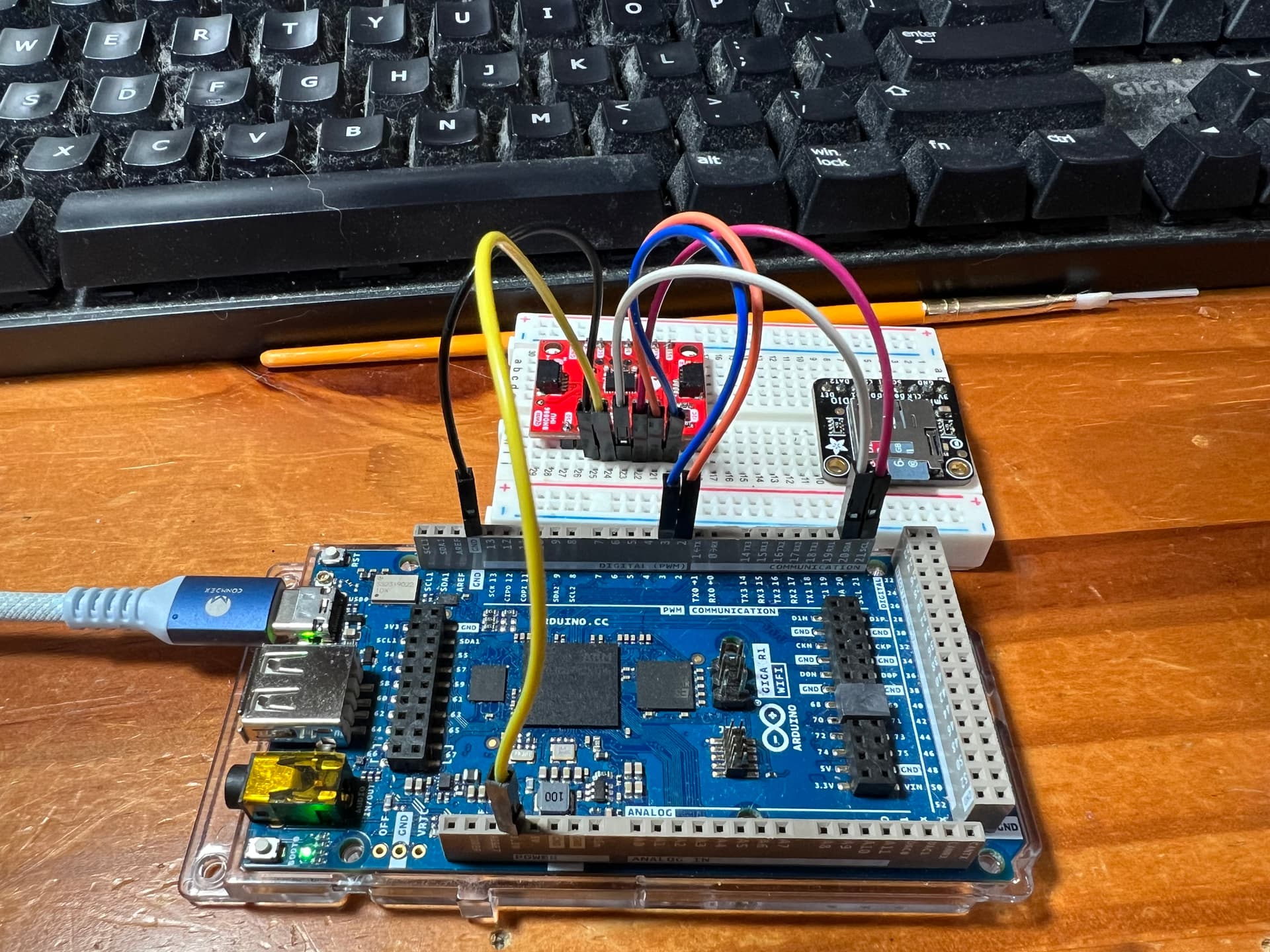

Sorry for taking long to answer - was off doing chores :slight_smile: Anyway here is a series a pictures so you can see the connections and wires the red light after loading at 350khz:
and red light at 350khz
Now I checked that at 350khz it works on a Teensy Micromod plus according to the reference issue it works on a ESP32. I can check other boards.

Thank you for the photos, there is nothing wrong with the connections.
