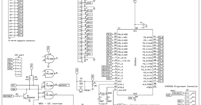

Hello guys,
For anyone interested, I built a contraption that can be used with Arduino. It is an I2C keyboard controller made from TI-99/4A matrix keyboard (made by Mitsumi, they were available on e-bay new and cheap some time ago) and AT89S52 (8052 compatible) micro controller. I don't think this qualifies for a Playground/wiki entry, but may give the hobbyists some ideas if they are in possession of a matrix style retro keyboard or a keypad. This project is open and can be adapted to any matrix keyboard by changing the firmware and perhaps few electrical connections to adapt to the specific keyboard connector.
