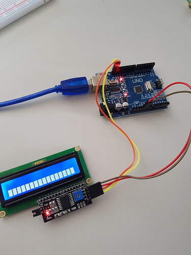

I have an I2C LCD display connected to a CH341 (UNO board) and i can't display any text on it.

I adjusted the potentiometer and that is not helping my problem, but the contrast is changing.

My SDA and SCL pins are connected to the SDA and SCL ports on the board but i also tried connecting them to the ports A4 and A5 and that didn't work.
I attached some photos to help, in one of the photos the potentiometer is turned all the way left.
Thank you in advance for the help!
Solder the backpack to the LCD. And show a photo of "your soldering".

Have you tried the contrast adjustment?
For an I2C LCD display to work, the I2C address and the I2C backpack to LCD pin mapping must be correct. If the library default settings for either or both are not correct the LCD will not work. You can try to figure out the right pin mapping and use an I2C scanner to find the address, but if you install and use the hd44780 library that is done automatically by the library.
Install the hd44780 library. The hd44780 library is the best available for I2C LCDs. The library is available in the Library Manager. Go to Library Manager (in the IDE, Sketch, Include Libraries, Manage Libraries) and in the Topics dropdown choose Display and in the Filter your search box enter hd44780. Select and install the hd44780 library by Bill Perry.
The class that you want to use is the hd44780_I2Cexp class. There are examples to show how to use the library. The nice thing about the hd44780 library is that it will autodetect the I2C address and the I2C backpack to LCD pin mapping.
In the examples, there is a diagnostic sketch that will help us to help you if you still have trouble with the display. Run the diagnostic sketch and post the results.
Hmm, yes, please do reassure us that the backpack is actually connected to the LCD display before you do anything else. :astonished:
Then install "hd44780" library via the IDE Library Manager. (and read the instructions e.g. click on More Info in the Library Manager)
David.
i soldered the backpack and now it's working, thank you!
