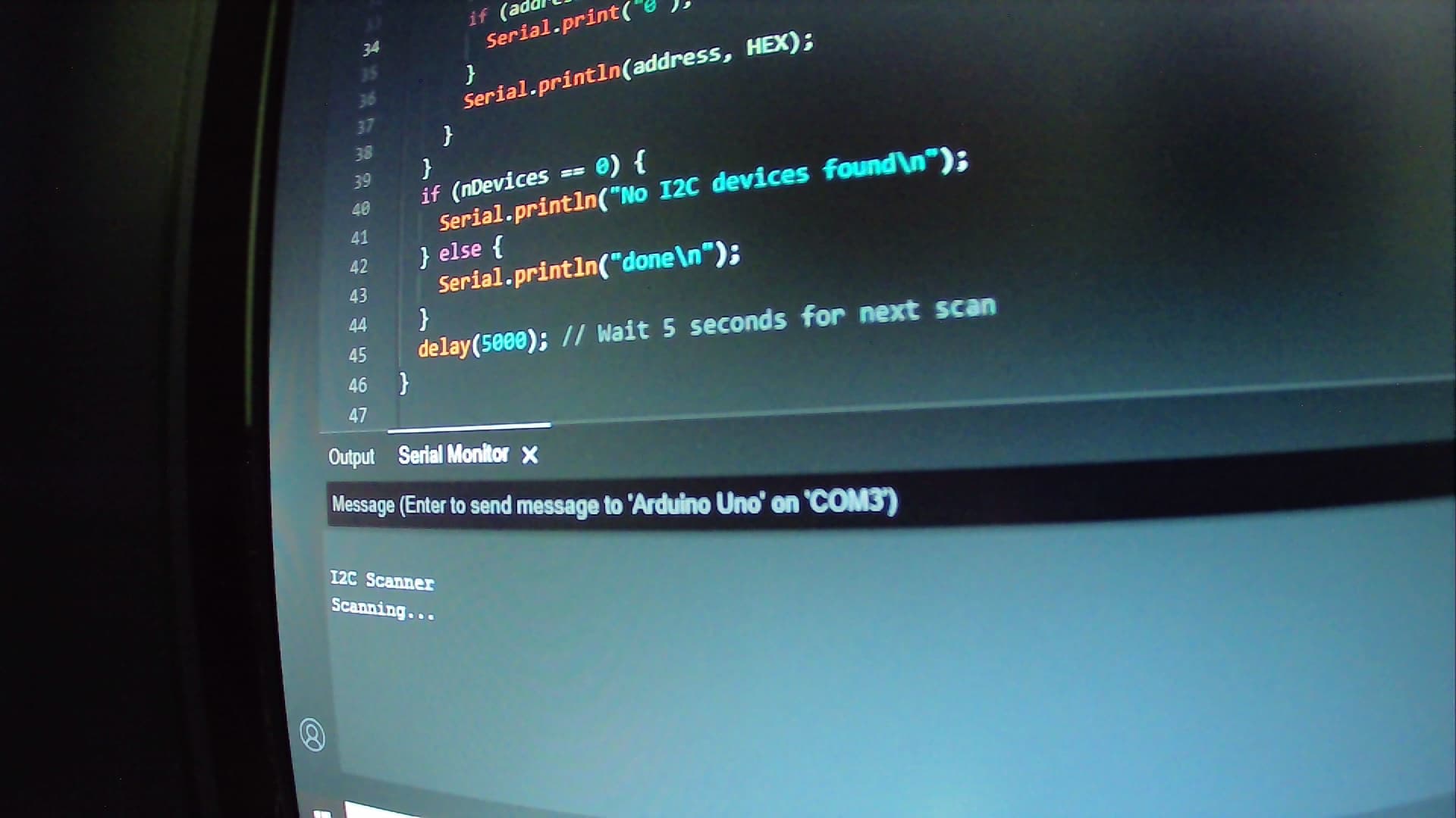

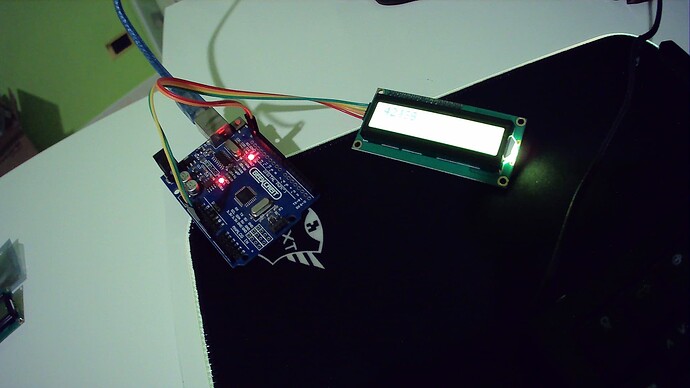

Hi, I've been trying to use this lcd for quite a while, but everything I did doesn't work at all.
Of course i've tried the scanner code, both from the IDE and from online so there are no problems on the core nor the library themselves, but it deosn't work, it just gets stuck on "Scanning..." and doesn't even re-try after a while.
Still, here's the code and the photos of the connections and the monitor output.

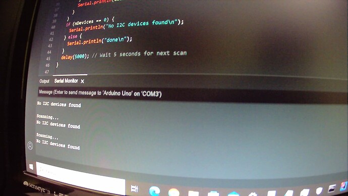

What happens if you run the scanner with nothing connected to the Arduino ? Does the scan run and report no devices found ?

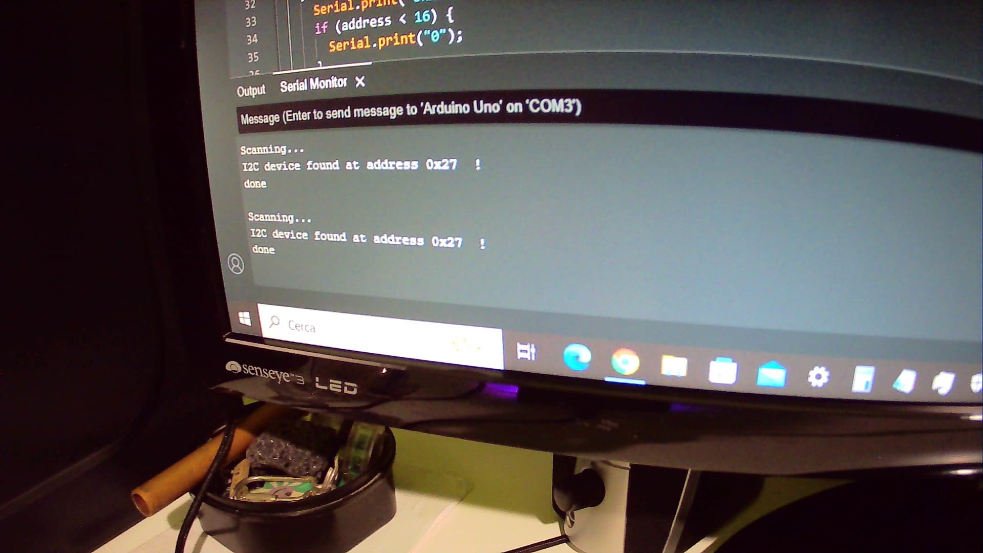

Hello alexmastang
Have made a cross check.
Scanning...
I2C device found at address 0x27  !
done
You have to check the wiring.
Yes, it does
I did check the wiring, it's all connected properly, as you can see in the pictures.
I didn't mention this, but i tried the exact same thing also on the anolog pins A5 and A4, same result.
Nevermind, I did check with another lcd, it's IDENTICAL and turns out the previous one is likely broken, the new one works flawlessly.
Anyway, thanks for the help!

A request :
Next time you need to post Serial monitor output, please select it from the Serial monitor and post it here in code tags rather than posting a blurry, oblique angle photo of the screen
