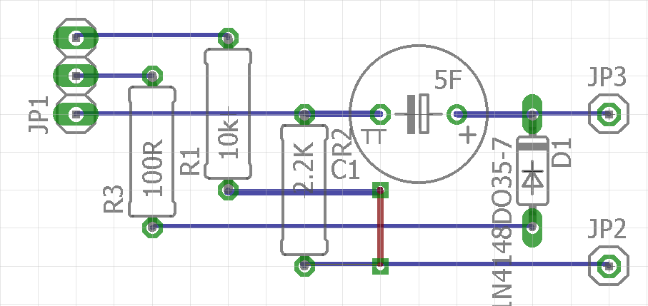

I run 2 voltages on my train
24V ( it comes nearer 26 when full charged) This runs everything except the arduino
5V regulated down from the 24V line for the arduino and LCD
I have a voltage divider on the 24 volt line that gives me 4v to 5v depending on the battery charge level
I take this 4v to 5v to pin 2 and it drops as soon as I kill the main batteries
the regulated 5v to the arduino goes through a diode and sits charging a supercap which powers the arduino .and LCD
the diode stops the cap discharging back through the rest of the circuits
When the main power drops the 24v line drops instantly and so triggers the interrupt on pin 2
but the super cap powers the arduino and LCD for several minutes before discharging too much
Once it tells me it has saved the data , ( which it now does thanks to your help) I then switch off the connection from the super cap to the arduino
I will try to put a bit of a diagram on this post .
on the diagram JP2 goes to pin 2 on the arduino
JP3 is the uninterruptable power supply from the super cap which goes to power the arduino
JP1 top to bottom is
24V
5V
GND

Here is the circuit
