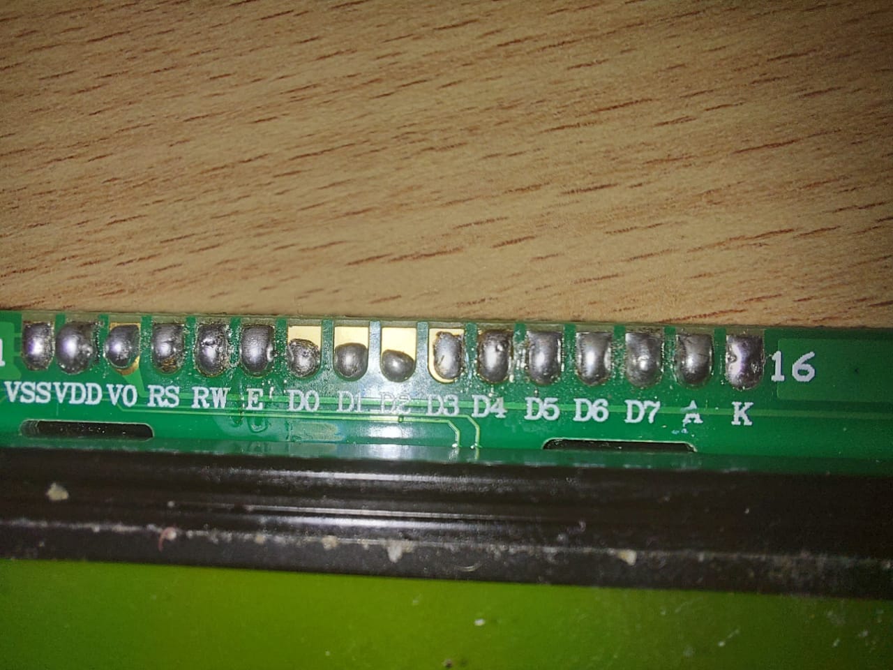

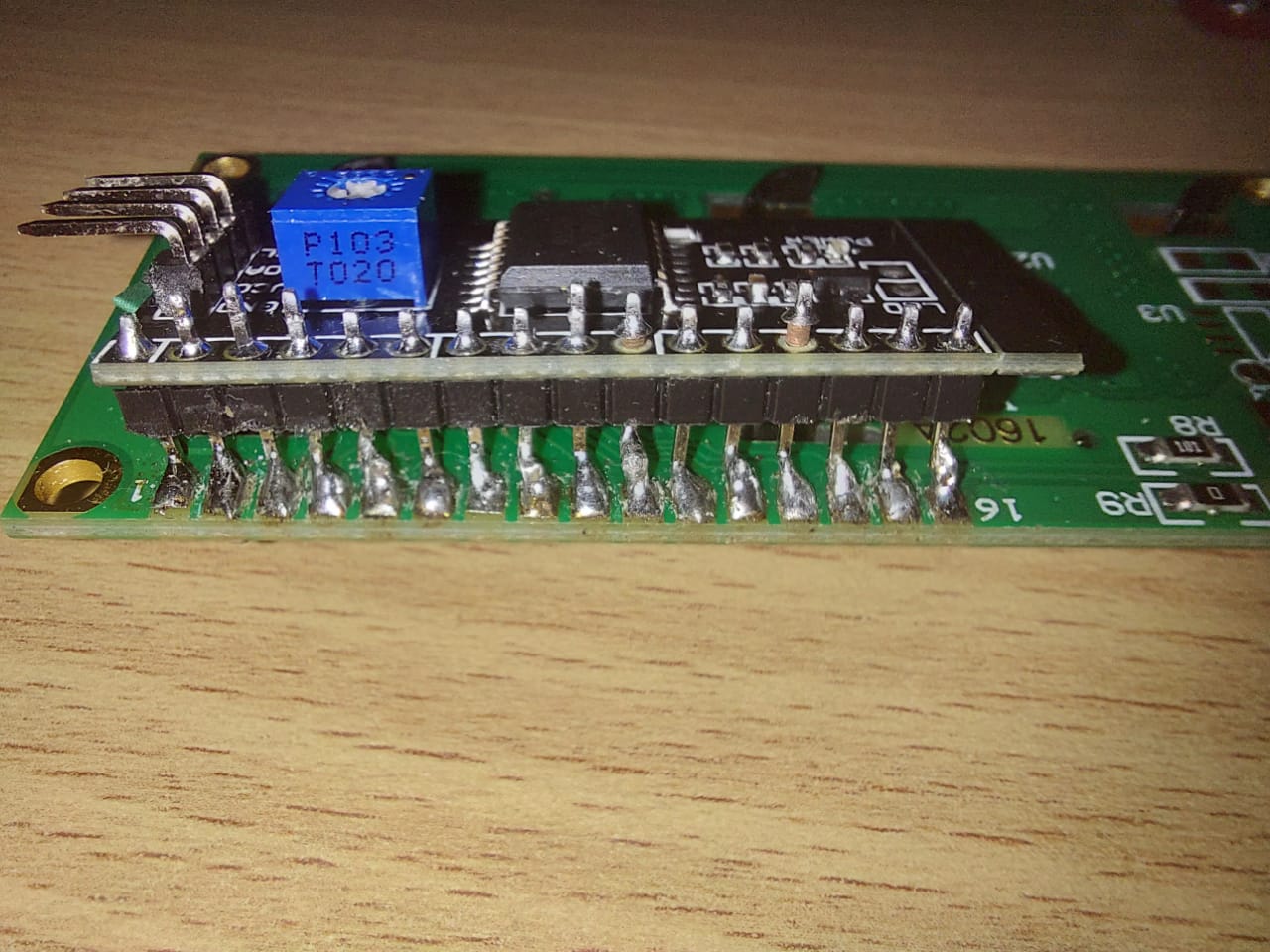

Soldering pics:
I think they are good. And no, those aren´t tin particles its just dirt and leftovers from scratching lol

I guess the soldering isn´t well done.
Really, buy a new display with the backpack attached.
