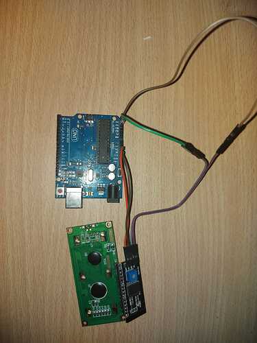

Okay, I've been reading and reading and there is no solution for my problem. Please I need help really quickly.
I am trying to make this Lcd 16x2 work with the i2c and Arduino UNO, I tried with a lot of libraries and with all of them I have the same problem (using the Hello world example codes), the lcd shows this black blocks on the first row (and I cant turn on the backlight tho idk)
My connections:
I2c Vcc - 5 V Arduino
I2c Gnd - Gnd Arduino
I2c SDA - A4 Arduino
I2c SCL - A5 Arduino
I2c's led its ON, Arduino's leds are ON, LCD its ON showing the blocks (without the backlight)
By the way sorry if my english its not that good.
One of the examples codes from librarie "hd44780" by Bill Perry
I tried this librarie because i saw that work in other post but now its not :frowning:

Post an image of your setup. Post a code that does not work. Post a schematic.

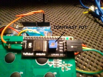

Have you tried adjusting the contrast pot?
Yes, I tried. It doesn't change anything.
It does not change the appearance of the blocks?
No, It doesn't.
Well, that is unusual. By adjusting the contrast pot you should be able to make the blocks disappear and re-appear.
Is that what you are adjusting?
As was asked by @Idahowalker in reply #2, please post clear photos and a schematic of your setup.

I wish that you would have posted the photo when first asked. We would have saved a lot of time answering your urgent question.
The backpack is soldered on backwards. It must be turned around. See the photo in reply #7.

If I soldered that way, there is a short-circuit and the Arduino doesn't turn on
The backpack is backwards. The LCD cannot work with the backpack connected backwards. Those are facts.
I do not know what would make it look like a short. I do not know what you did. I do not know what you saw.
I connected all exactly the same. I didnt change any connection. But when I connected the Arduino to the PC and to the I2c, the Arduino's leds didn't turn ON, but when I disconnected the I2c they do
idk if I explain myself
My best guess is that there was a solder bridge between pins 1 and 2 of the LCD. Those are Vcc and ground. A tiny solder bridge can conduct enough to overwhelm the regulator and the Uno shuts down. How good are you at soldering? How carefully do you examine your solder joints? Do you know what to look for?
Ush... Maybe that was the problem. But Im sure I'm sure I checked more than once every solder. I will try to solder back the right way and see if work like that.
