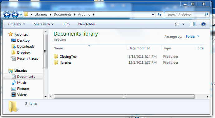

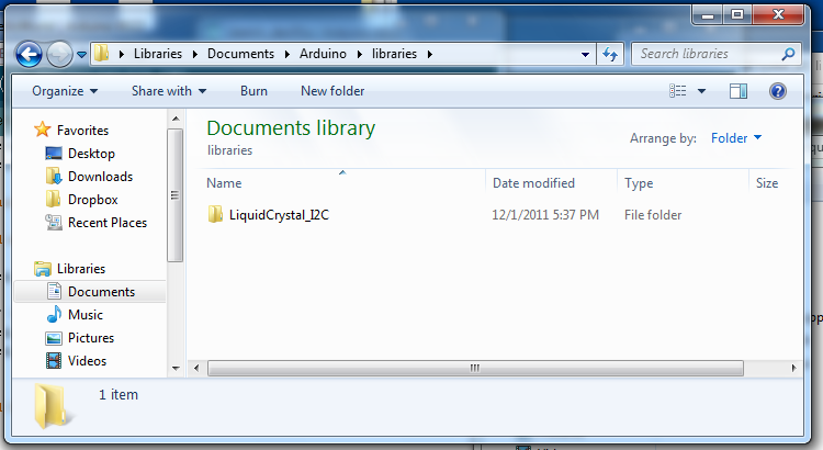

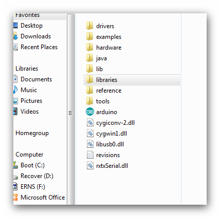

My operating system is Win7 home, the IDE is 0023,here are shots showing 0023 open and the inside of the libraries folder.

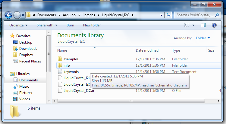

Aside from the fact that user installed libraries should be in the libraries folder in the user's sketch directory instead of that directory, the library should now be accessible. This presumes that the contents of that folder are correct. One more picture, please, of the contents of the LiquidCrystal_I2C folder.
Your screenshots are better than nothing, but realize you completely obscured the path. There is enough there for me to see that you didn't listen to my original advice.

Your Sketches are stored in the path:
(XP) C:\Documents and Settings\username\Arduino
(7) C:\Users\username\Documents\Arduino\
That's where you need to create a libraries folder for you to put YOUR downloaded libraries.
See my screen shots.
User owned libraries: path where Arduino.exe stores your sketches
libraries contents and LiquidCrystal_I2C contents are the contents of the respective folders.
Contributed libraries in IDE shows how LiquidCrystal_I2C appears correct in the IDE.
