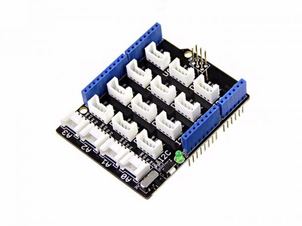

Grove shield
https://www.seeedstudio.com/Base-Shield-V2-p-1378.html#
I added in attachment the mpu 6050 wiring diagram. We couldn’t find the Grove shield on fritzing so we used instead A4/A5 arduino pins for I2C communication.
The I2C motor driver is directly plugged to an I2C port of the Grove.
