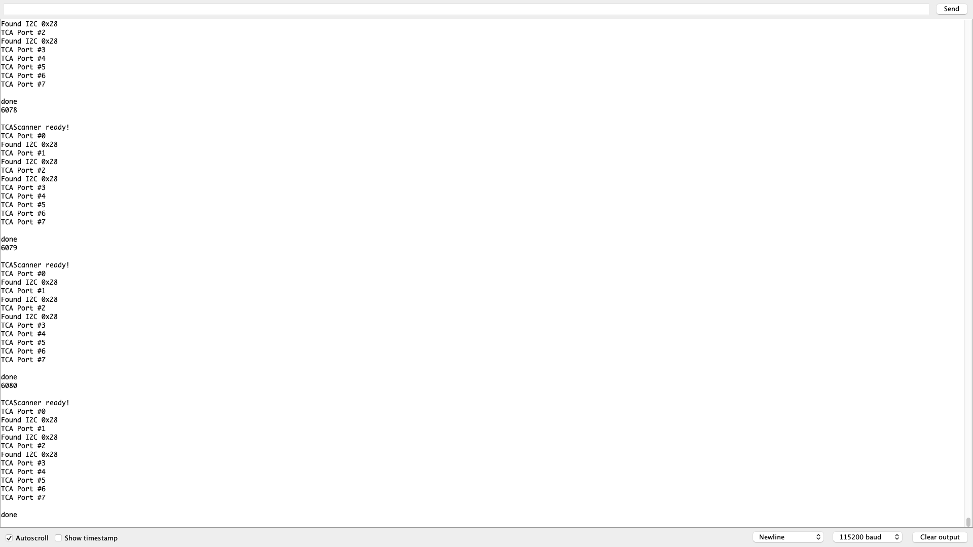

Which is able to check, for at least 6080 runs that the three IMUs are conencted to port 0,1 and 2 of the multiplexer (See 6080 successfullruns.png).

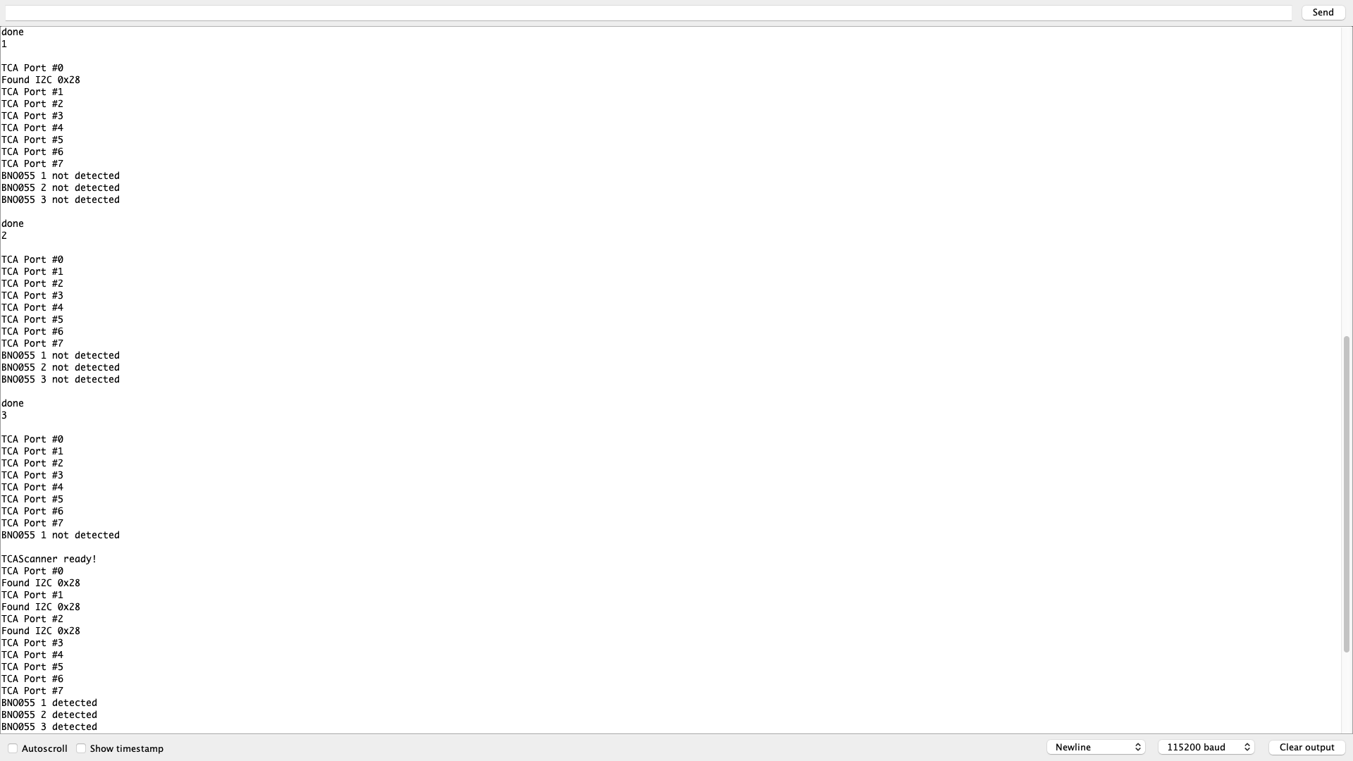

This code shows an eratic behaviour (part 1 and part 2.png):
  1. From the start, the three 0x28 are detected
  2. Then, I tried to connect to the IMUs:
  • 2a. At the start, no conenction is possible
  • 2b. Everytime I press the reset button of the arduino, I'm loosing a 0x28
  • 2c. When I unplug and replug the 5V pin supplying the multiplexer and the IMUs, I can find all of them and the connection are working for a single run.
I was first guessing this behavior was due to few poor connection on the classical white female pins board. I bought PCB board, solder everything together and the problem still remains.
Having the three IMUs connected with bno.begin tells me the Imus are fine.
Having some eratic connections with the IMUs (even when reset and +5v are pushed or disccoencted) leads to first hypothesis: it seems to the be a software issues, maybe IMUs should be disconnected once used of the TCA port msut be closed, I do not know.
I'm really lost to find the solution. Signal looks ratehr fine with the scope.
Any idea how to solve this issue or test to perform?

Here I got a copy-paste from the stick seriel monitor:
TCAScanner ready!
BNO055 1 detected
BNO055 2 detected
BNO055 3 detected
done
BNO055 1 detected
So the BNO055 fails in the first llop. It was working in the setup ... I do not understand why ....

I got this for all three of them:
⸮⸮POrientation Sensor Raw Data Test
Current Temperature: 31 C
Calibration status values: 0=uncalibrated, 3=fully calibrated
X: 0.00 Y: 0.00 Z: 0.00 CALIBRATION: Sys=0 Gyro=0 Accel=0 Mag=0
X: -0.06 Y: -0.06 Z: -0.06 CALIBRATION: Sys=3 Gyro=3 Accel=3 Mag=3
This rawdata example is working fine with a single BNO055, I got consistent data.
With this TCA, the conenction can be made, but the answer are strange ....
Maybe the pull-up resistors ... I really don't know. llokign for any advice, tip, etc.
