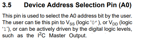

In principle the i2c address should be set on init, the chip could update its address on reset only, so the setup should use only 2 of them and hw A0 to GND and VDD. There are I2C multiplexers also to help address collision like this.
Peripheral IO hardware devices
The above is a partial description. The full description is below which advocates that more than two devices can be operated using I2C bus with A0-pin dynamically controlled.
A0pin
