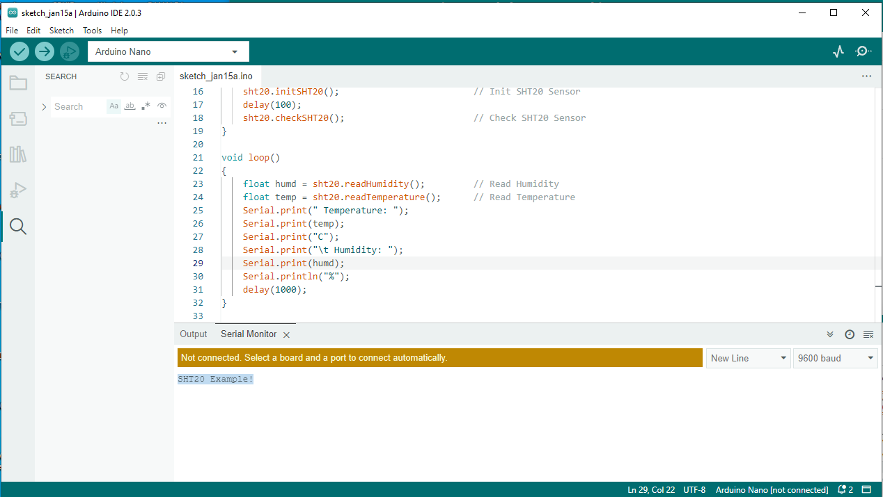

the result of the sht20 program only prints
SHT20 Example!
it does not print the word temperature and Humidity

I have tried it, i also post the code but im not sure i did it right, when i run it and use the serial monitor it prints only "I". I also include an image

Good day i have tried your suggestion and it work but sadly it has the same problem as this
we have the same result. it must be that the 5v and no resistor damage the sensor. thank you for assisting. i will purchase a new sensor :cry:
