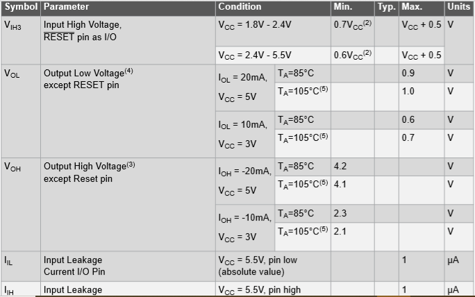

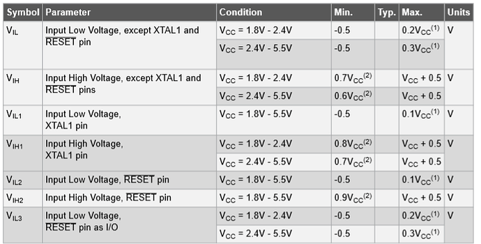

When the ATmega328P is running from Vcc supply of the range: 2.4V to 5.5V, the minimum VIH that will be reliably recognized as logic HIGH is 3.0V (0.6*5) for 5V supply at Vcc-pin .
Figure-1:
Figure-2:
pert:
That would be a waste of time and could actually be harmful. 3.5 V is the minimum and running right at the minimum is not a good thing. Being above the minimum at 3.65 is a better situation.
Why is it concerned to operate the circuit much above the minimum level of VIH (3.0V)? This is related with 'Noise Margin' of the digital circuit/gate. When a source signal (it is 3.5V in your case -- the OP) drives a destination, it picks up 'road noise' or 'environmental noise'. When the signal arrives at the destination (the driven gate), it might add negative noise of 0.6V (600 mV); as a result the signal becomes 3.5 - 0.6 = 2.9V which is below the minimum requirement of 3.0V and the circuit will malfunction as 2.9V will not be recognized as logic HIGH. Therefore, the noise margin of the circuit must be improved. The noise margin is improved when the the driving signal does not go below VOH (4.2V, Fig-2). Now, the noise margin for the same -0.6V noise is: 4.2 - 0.6 = 3.6V which is much higher than VIH (3.0V, Fig-1). So, check why the SDA/SCL signals are at so lower level of 3.5V.
GolamMostafa:
You're right. I must have been thinking of the ATmega4809. Thanks for the correction.
