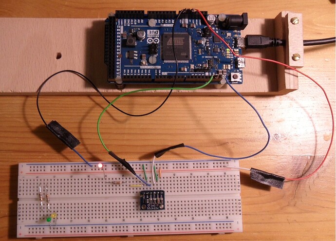

Hello Chris,
thank you for your reply.
I could connect a MCP4725 Breakout Board (12-Bit DAC) with an I2C Interface ( MCP4725 Breakout Board - 12-Bit DAC with I2C Interface [STEMMA QT / qwiic] : ID 935 : $4.95 : Adafruit Industries, Unique & fun DIY electronics and kits ) via SCL1 and SDA1 (Wire1.xxx) to an Arduino Due.
If some one is interested I will post the code once I have a more intelligent sketch (e.g. dimming and increasing the light output of a red LED) than the stupid first version which just tested the I2C connection to the 12-Bit DAC (reading it and setting a few DAC values).
The "MCP4725 Breakout Board" has 10 K pull up resistors for SCL and SDA which made it necessary to use the SCL1 nad SDA1 on the Arduino Due (because SCL1 and SDA1 have no pull up resistors on the Arduino Due board).
It is a shame that the standard I2C interface ( SCL = pin 21 and SDA = pin 20) has 1 K pull up resistors on the Arduino Due board, which makes it pretty much useless for most I2C ICs (because they can not pull down 3.3 mA).
My question: Where are these 1 K pull up resistors (RN5D and RN5C) on the Arduino Due board? I might try to remove them.
Greetings, Conrad
