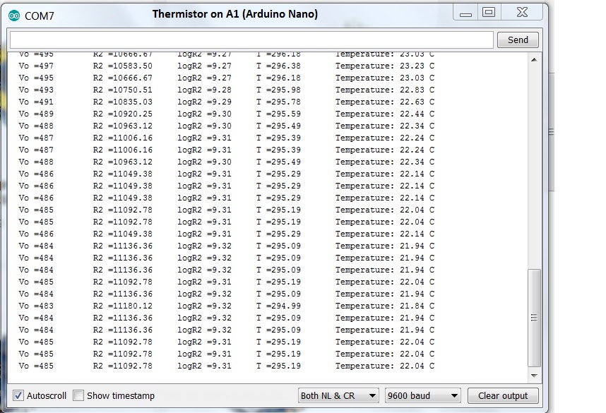

Vo should not be near 0 or near 1023.
Measure the resistance of the thermistor, out of circuit, on its own.
Measure the resistance of the 10K resistor, out of circuit, on its own.
If you like, take the thermistor and 10K out of circuit and connect the A1 pin to 3.3V pin and see what the serial monitor reads.
Vo should be around 660.
Tom... :slight_smile:
Thank you Tom, much appreciate your help!

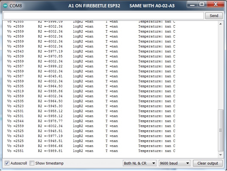

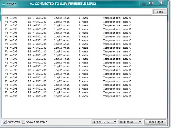

It works now on arduino nano (attached) but still not working on FireBeetle (attached) . I guess some compatibility issue although as stated by the manufacturer is a 100% compatible with Arduino. A1 Vin on Firebeetle is 2.21v (When connected to thermistor and 5v) as you suggested.
A1 to 3.3v on firebeetle reads : Vo =4095 R2 =-7501.83 logR2 =nan T =nan Temperature: nan C
so nothing like 660.
I guess I have to look more into the firebeetle esp32 board .
Thank you again very much for your help!
Rather than taking multiple screen-shots you can copy and paste the text from Serial Monitor.

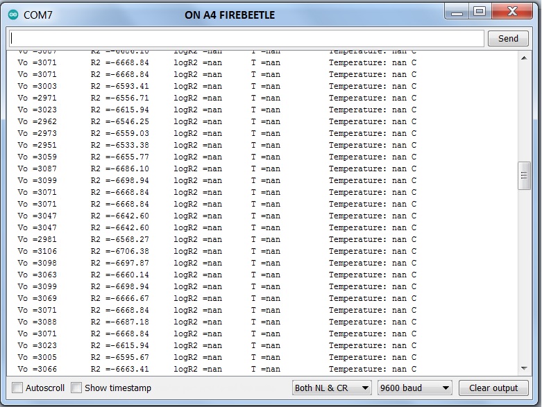

Looks like the "1023.0" in your sketch should be "4096.0" since the ESP32 uses a 12-bit ADC instead of the Arduino typical 10-bit ADC.
As @johnwasser has pointed out, the ESP is 12bit that is 4096 counts from ADC, so change this line;
 R2 = R1 * (1023.0 / (float)Vo - 1.0);
To;
 R2 = R1 * (4095.0 / (float)Vo - 1.0);
It looks like the ESP32 input is giving valid values with the thermistor connected, just the raw data to scaled data calculation needs changing to the different ADC.
