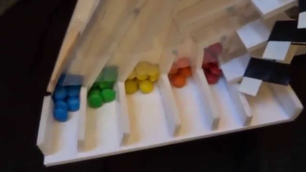

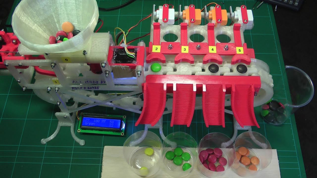

not sure why no one pointed out that sorting colored M&M candies is old hat.
slow version :
slow
faster
I think a lot of the slow aspect is to move the part and have large bins.
if I was to do this, I would use long skinny bins and move the arm a much shorter distance.
you could have chutes that run to larger bins.
on the last video, I think the color sensor is on the marble that is next in line. it has a long time to sit while the piston is activated.
