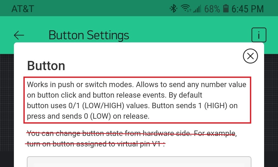

Blackfin I'm using an android app called Blynk which connects my NodeMCU and android phone together via a cloud server. In this app I can directly set any pin I want to HIGH or LOW with virtual buttons on the screen. However I'm trying to simulate a momentary 2 second button via code as I can't program this on the Blynk app. It works great with delay (first code I posted) however I want to use millis() with no delay.
I've been playing with danardos code but it's not working. I believe it's because the code is assuming it's a button that's being pressed when in fact the app it's just writing HIGH or LOW command to the NodeMCU.
Show the code where you receive HIGH and LOW
First image shows the description of how the Blynk virtual button works.
Second image shows the virtual button when is pressed which sends the signal to the NodeMCU via the cloud. I know the buttons work because I can engage my relays with no issues however one of the relays I need to automatically go LOW after 2 seconds after it gets triggered to go HIGH.
I was hoping code below would work but no luck.
