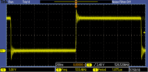

Case 1 - Running code within the loop() function:
  PORTB ^= 0xFF;
Case 2 - Running code nested within a for ( ;; ) loop within the loop() function:
  for (;;) {
    PORTB ^= 0xFF;
Case 1 can toggle the state of PORTB at 533kHz while Case 2 can toggle the state of PORTB at 1.6MHz. This is an impressive improvement.
Given that with everything else our code will be doing, as a ratio, this overhead may not amount to very much -- it does count for something and is very easy to work around at the expense of a for loop. Surprisingly, the compiled size of both cases was 4274 bytes. This tells me that the compiler's optimizer successfully optimized the code and there is no negative impact in terms of using more flash storage.
Attached are two screen shots from my scope. The first "loop" describes case 1 and "loop for" describes case 2.
For reference, this is running on an atmega32u4 at 16mhz.
