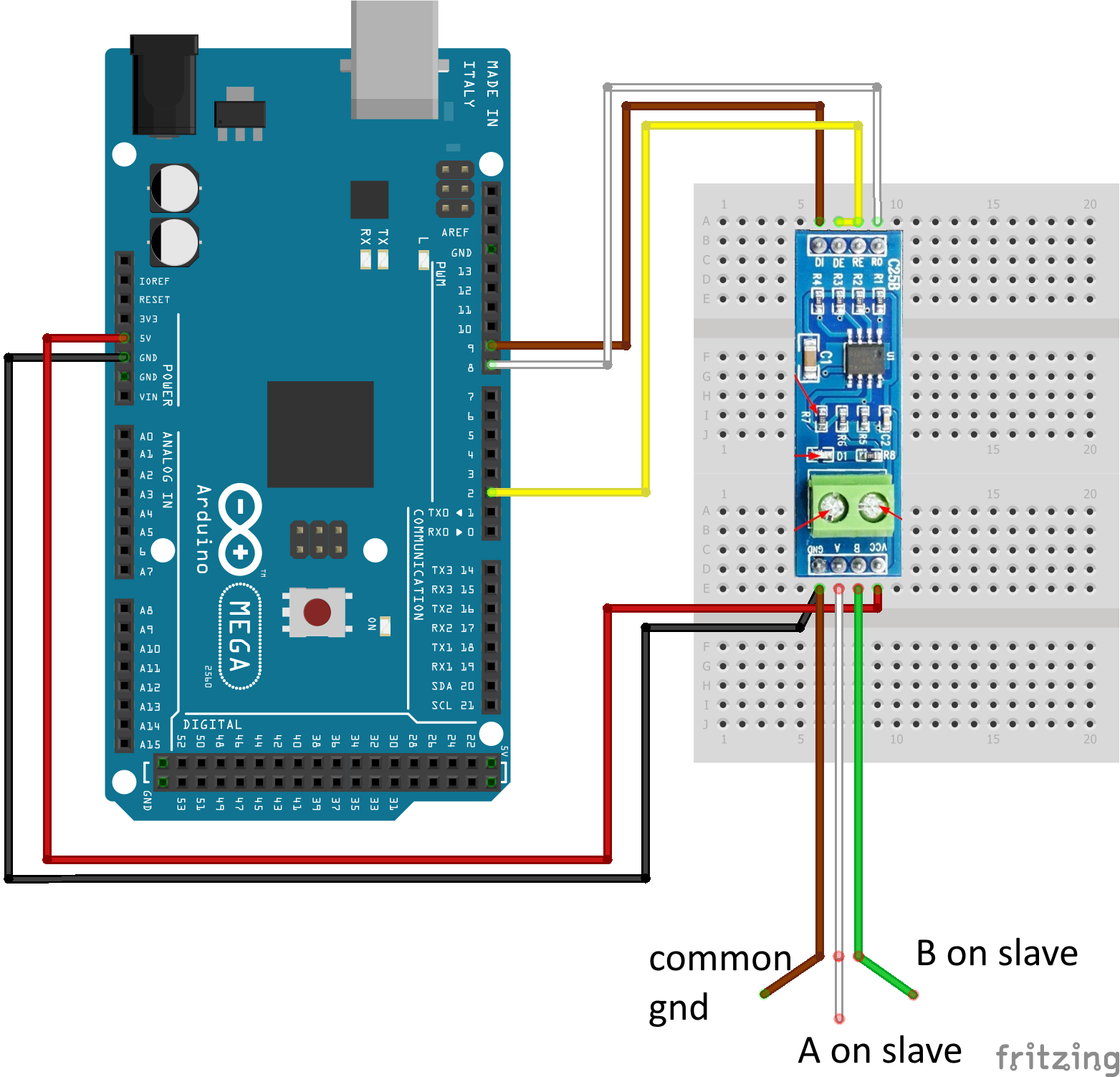

Hi there Arduino Community!
I have been very busy with this project but i have been stuck on this part for a little while now, i just need to be able to read 1 simple holding register from my Modbus slave device and i will be able to continue.
I have a MAX485 to TTL module hooked up between the Arduino Mega and the Modbus slave.
i have read many and many different forum posts and watched loads of youtube videos but none of them really seem to work. ill provide as much info as i can so hopefully someone can help me out.
So the Slave i am trying to connect to is a regulator that collects data from temperature sensors. i want the Arduino to read the data that is collected by the regulator so i can confirm that the regulator is doing the correct things it should do.
Using the code as shown here i noticed that only the RX light seems to be flashing and not the Tx light. so i am assuming there is no request being sent out to the slave and thus nothing can be received.

This is the exact wiring of how i have it set up right now.

In the code of your first post, your code says pin 3 controls RE & DE but your diagram shows pin 2 is used.
The modbusmaster library includes 2 callback functions just so that you can switch RE and DE at the correct time without using any delays.

thanks for your reply mark!
i will try again but with the hardware serial this time!
maybe that will be the golden solution. and you're right about the wiring scheme i see now haha, but i can assure you i wired it up correctly. let me try the hardware serial and i will let you know!

DI = Tx0, Ro = Rx0, Re = pin4, De = pin 3. i have checked the wiring.
Use Serial1 for your RS485 Comms.
ah yes good one, the gibberisch is gone now, but sadly still no luck on the reading part of the data. the arduino does not seem to be sending the request no to the slave sim. maybe my code is a bit off, still early today hahha.

i think i got it. as we can see weve got a serial coming in and a serial going out from the RS485 converter. the serial coming in is identical to the value i see in the modbus slave simulator which is the request. the value going out is identical to the one being sent back to the arduino from the slave simulator.
@markd833 It works!!
my dumb head didnt realise i need to switch the Real life serial port connection to serial1 aswell DUUHH. now i switched to RX1 and TX1 and boom it has a connection!
