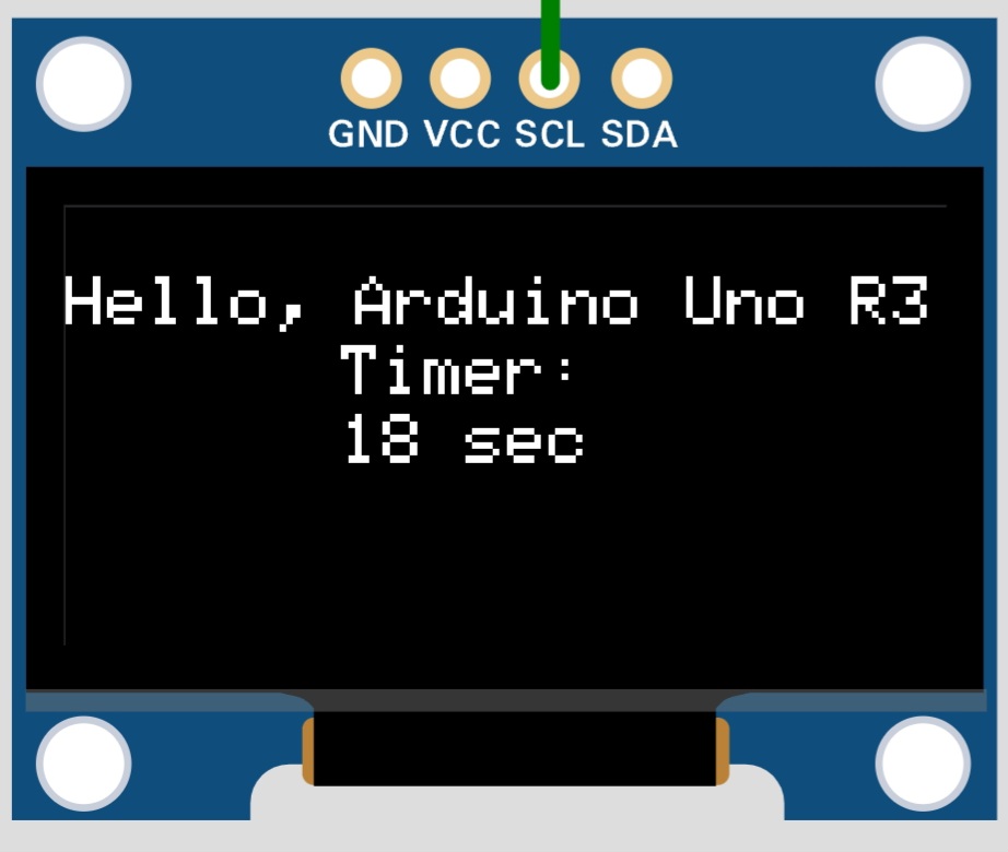

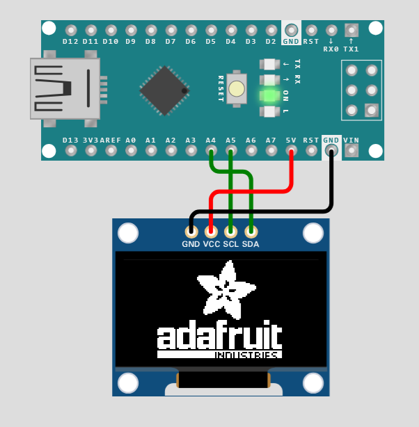

I want to make a timer with an OLED SSD1306 display and an Arduino. The code only does the beginning. Can you help me fix this?

do you want to print this every second ? this should be in the setup
also you never erase the display so the prints will be in overlay...
try something like this, typed here fully untested

you could avoid some blinking by keeping the text always in the same place (here "sec" will move around as you add digits) and only erasing the part for the number of seconds

oled.setTextColor(SSD1306_WHITE,SSD1306_BLACK);
before
oled.setCursor(40,10);

#include <Adafruit_GFX.h>
#include <Adafruit_SSD1306.h>
#define OLED_RESET 4
int secs = 0;
Adafruit_SSD1306 oled (128, 64, &Wire, OLED_RESET);
oled.begin(SSD1306_SWITCHCAPVCC, 0x3C);
oled.display();
oled.clearDisplay();
oled.setTextSize(1);
oled.setTextColor(SSD1306_WHITE);
oled.setCursor(0,10);
oled.print("Hello, Arduino Uno R3");
oled.setCursor(40,20);
oled.print("Timer:");
oled.setCursor(40,30);
oled.print(secs);
oled.print(" sec");
oled.display();
oled.setTextColor(SSD1306_BLACK);
oled.print(secs);
oled.print(" sec");
oled.display();
secs += 1;
